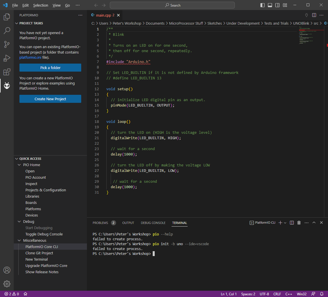

OK Max, I tried the pio init, but failed miserably. There’s got to be something fundamentally wrong here.
As soon as I clicked on “PlatformIO Core CLI”, the “failed to create process” message was displayed and then the same again after I tried the pio init command.
Anyway here’s a screen dump …

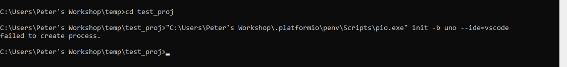

Otherwise, Please login to your real user account, open a windows terminal (Windows + R → cmd.exe) and execute
mkdir temp
cd temp
mkdir test_proj
cd test_proj
"C:\Users\Peter's Workshop\.platformio\penv\Scripts\pio.exe" init -b uno --ide=vscode
No my original test project was on the local machine.
Here’s the result of the cmd.exe test…
