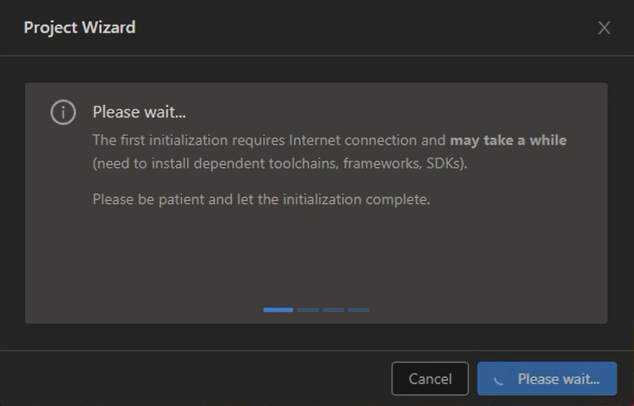

As the project is being created, the following screen appears. However in all my previous failed attempts, this screen would just flash by and do nothing.
So the question is, why does this not work in my preferred folders?
