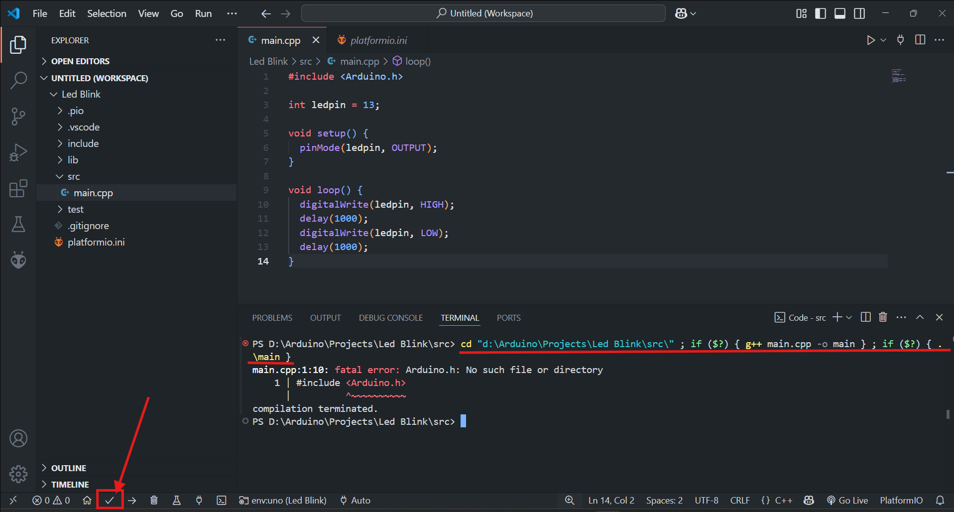

Main.cpp:1:10: fatal error: Arduino.h: No such file or directory
Every time I run the code I get this error main.cpp:1:10: fatal error: Arduino.h: No such file or directory . I am newbie, your help is very much appreciated.

Please use pre-formatted text, not image!

Where does this text come from??
Did you use the build button in the bottom bar?
That text is the directory of the main.cpp file stored in my computer.

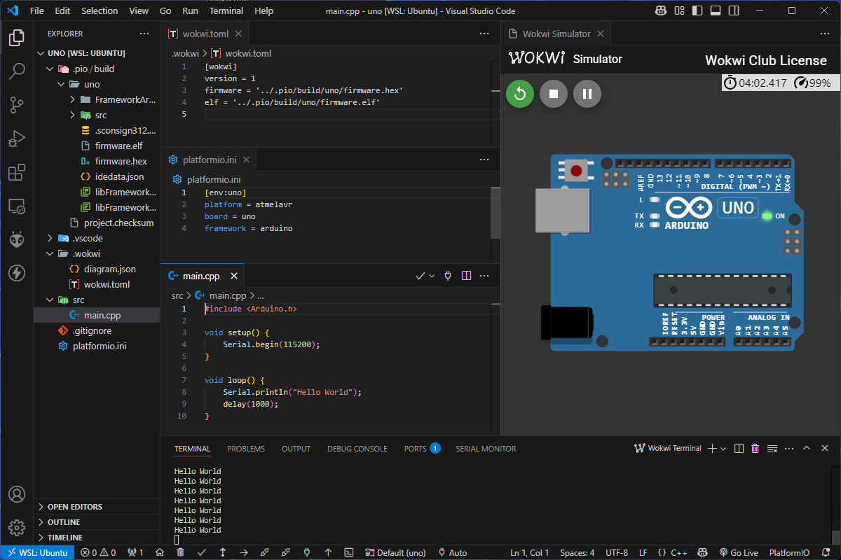

Where is your wokwi.toml file located?
The paths to the firmware and elf file are relative to the location of the wokwi.toml file.
Example:
Filestructure:
β”œβ”€β”€ .pio
β”‚   └── build
β”‚       └── uno
β”‚           β”œβ”€β”€ firmware.elf
β”‚           └── firmware.hex
β”œβ”€β”€ .wokwi
β”‚   β”œβ”€β”€ diagram.json
β”‚   └── wokwi.toml
β”œβ”€β”€ src
β”‚   └── main.cpp
└── platformio.ini
wokwi.toml
[wokwi]
version = 1
firmware = '../.pio/build/uno/firmware.hex'
elf = '../.pio/build/uno/firmware.elf'
Thanks this worked. <3
