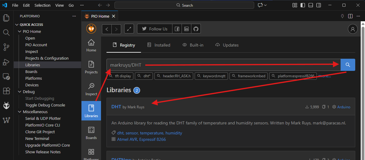

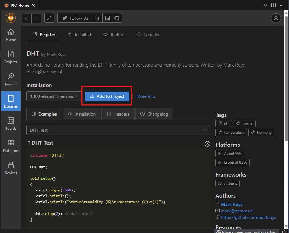

There are several ways to install libraries in a project.
  1. Via the GUI:
    Click on the PlatformIO icon and select Quick Access / PIO HOME / Libraries. Search for the desired library and add it to your project.
  1. Via CLI command:
