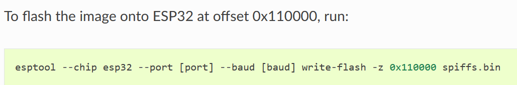

I saw this here

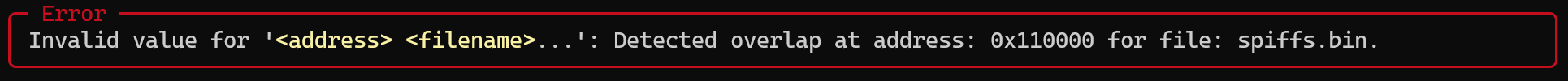

I tried adding “0x110000 spiffs.bin“, without the quotes, to the end of my working command line from above, but got:

The correct addresses depend on your used partition table (documentation).
You could manually calculate the absolute address of for your filesystem binary based on your selected partition table CSV file, but..
The simplest way is to simply sniff what exact esptool command PlatformIO uses when uploading the firmware and SPIFFS and replicate it.
On a PlatformIO Core CLI:
pio run -v -t upload
pio run -v -t uploadfs
Should give you, in the respective last lines of output, the esptool command, in which you can see the needed addrseses.

I got the info I needed to use esptool.exe to upload spiffs.bin and that works fine with this command:
.\esptool.exe --chip esp32 --port “COM3” --baud 460800 --before default-reset --after hard-reset write-flash -z --flash-mode dio --flash-size detect 0x290000 spiffs.bin
