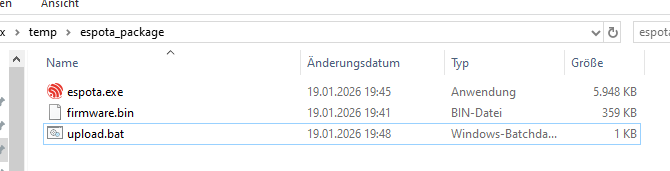

That means you can create a very simple “OTA firmware and uploader package” if you place these files in an folder:
  • espota.exe from the source above
  • firmware.bin, the firmware you want to upload (.pio/build/<env name>/firmware.bin)
  • upload.bat batch script which invokes espota.exe with the right parameters and expected IP address or even better, mDNS name (like esp32.local, if you setup your MDNS responder in firmware up correctly.. See docs and src)
The upload.bat can be a simple

So and entire upload package could just be this, where you double click upload.bat and it uploads the firmware (and filesystem). That’s it.
