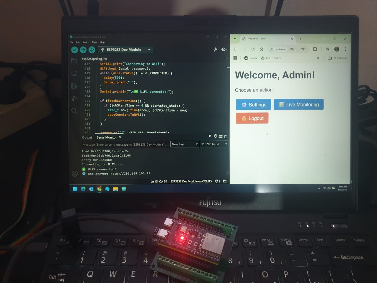

I have the same board (ESP32-S3 WROOM1 DEV MODULE CLONE N16R8). After searching for references in several forums, I managed to upload the sketch to the board using the Arduino IDE, and the code works.
