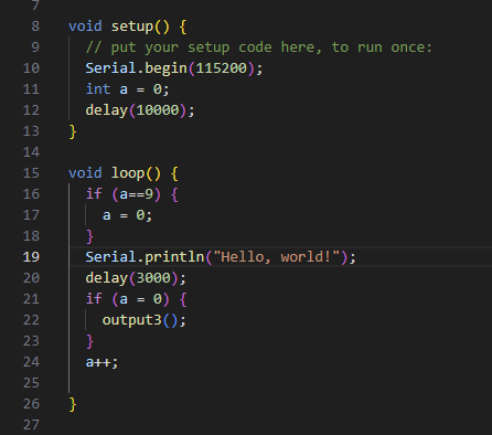

I am trying to test a simple “Hello, World” program on my ESP32-WROOM-32E devkit.

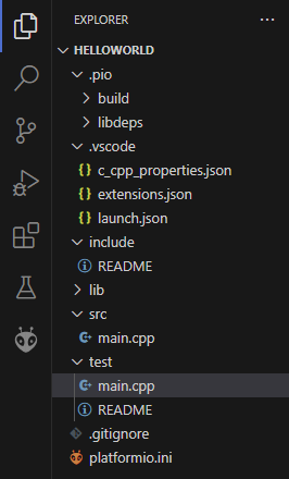

Here’s the structure of my file system for this project:
I even added a delay of 10000 to the setup().
When I build and test, it hangs indefinitely on the “If you don’t see any output for the first 10 secs…” message. I was able to get it to test just yesterday.

I’m pretty new so I feel like there’s something I’m missing. Maybe it’s the “main.cpp” in both the src and test folders causing confusion? How can I get it to actually test again?
