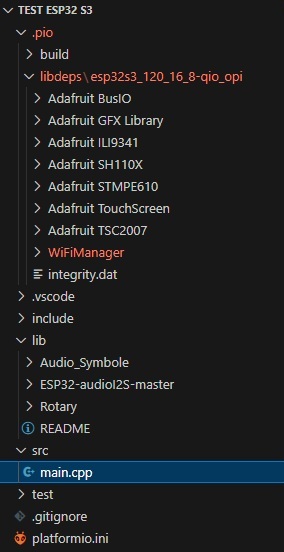

The project structure looks like:
Could you please enlight what I’m doing wrong.

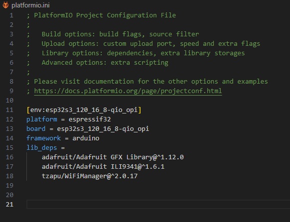

Please also show the content of your platformio.ini so we know exactly which libraries, versions etc are used in your project.
Hi.
[env:esp32s3_120_16_8-qio_opi]
board = esp32s3_120_16_8-qio_opi
adafruit/Adafruit GFX Library@^1.12.0
adafruit/Adafruit ILI9341@^1.6.1
tzapu/WiFiManager@^2.0.17
This is a custom board which might have some settings we don’t know.
Please also share the board manifest for this board (esp32s3_120_16_8-qio_opi.json)
The lib_deps sections in your platformio.ini must indented! Please make sure that this is just a copy and paste error and your platformio.ini looks like this:

The platformio.ini:
The error comes from the outdated / not updated WiFiManager library.
Change your lib_deps to:
  https://github.com/tzapu/WiFiManager
  https://github.com/schreibfaul1/ESP32-audioI2S
