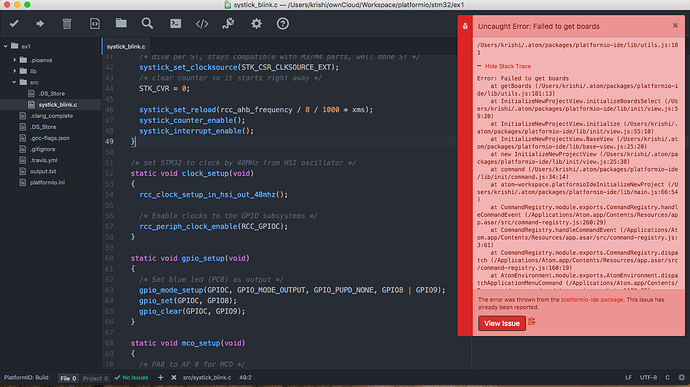

However, when I upgraded platformIO to 3.0 alpha the build system broke.
The boards folder was filled with several json files and the custom board.json was no where to be found.
So I tried again by recreating the customboard.json and initializing a new project, and thats where I got this error
Here is my board.json
{"disco_f030r8" :
"build": {
"core": "stm32",
"cpu": "cortex-m0",
"f_cpu": "48000000L",
"mcu": "stm32f030r8t6",
"variant": "stm32f030r8t6",
"ldscript": "stm32f03xz6.ld"
"frameworks": ["libopencm3","mbed","cmsis","spl"],
"platform":"ststm32",
"name": "ST STM32F030DISCOVERY",
"upload": {
"maximum_ram_size": 8192,
"maximum_size": 65536,
"protocol": "stlink"
"vendor": "ST"
and here is my platformio.ini
# PlatformIO Project Configuration File
# Please make sure to read documentation with examples first
# http://docs.platformio.org/en/stable/projectconf.html
[env:disco_f030r8]
platform = ststm32
framework = libopencm3
board = disco_f030r8
build_flags = -DSTM32F0
I just tried to reinitialize a new project in the same project folder but it failed.
Please help!!

The exception dump is informative
File "platformio/managers/platform.py", line 495, in __init__
assert set(["name", "url", "vendor"]) <= set(self._manifest.keys())
AssertionError
