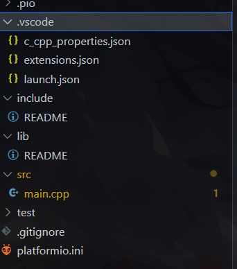

Can anyone tell me what is the problem?
Just create a project and run it and it will report an error message.
Please show the content of your platformio.ini and a smallest possible example to reproduce the error.

Thanks for sharing the content of your platformio.ini.
But I’m still missing the code

main.c:
// put function declarations here:
int myFunction(int, int);
// put your setup code here, to run once:
int result = myFunction(2, 3);
// put your main code here, to run repeatedly:
// put function definitions here:
int myFunction(int x, int y) {
return x + y;
It looks like your platform or the platform packages are broken.
