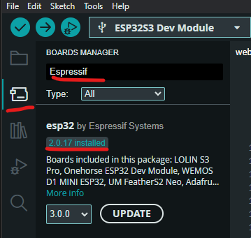

Some basic information are missing, such as the platform used, the board used, the version number of the framework used (both ArduinoIDE and PlatformIO).
To make a comparison, show a screenshot of your board settings in the ArduinoIDE and share the content of your platformio.ini.

ArduinoIDE:
Click “Boards Manager” on the left side.
Enter “Espressif” in the search bar:
In the screenshot above the Arduino version is 2.0.17.
