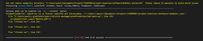

I don’t know why, after installing Python and PlatformIO, I can’t create a project or even compile it. But I can compile and upload to my Nucleo when Windows Defender is disabled. How can I solve this problem?
It is the Windows Defender which does wrongly delete needed files from Platformio
Hey @jason2866 how can i fixe that please?
As you did before disable Windows Defender or use WSL
Faster and no more issues with Windows Defender.
For native Windows there is no real solution. Ask MS.
