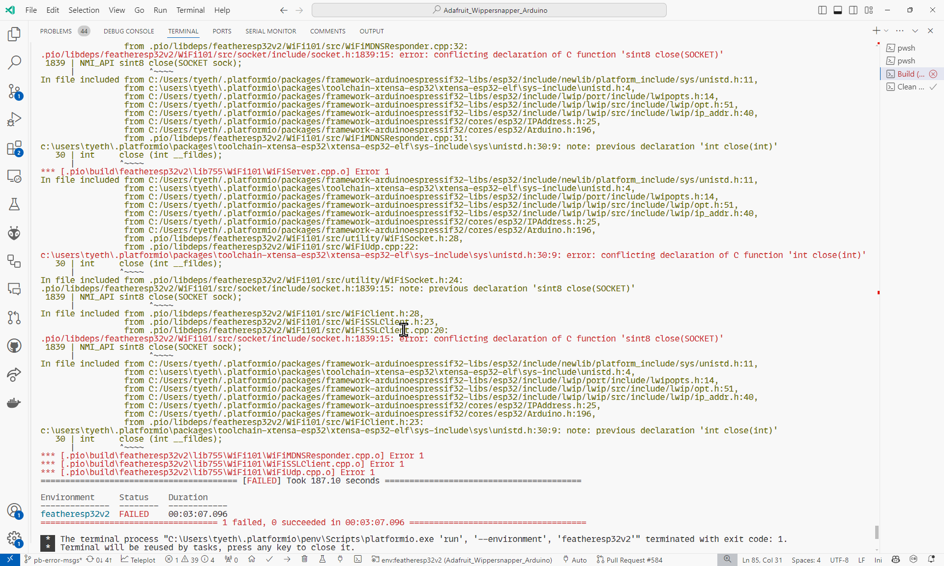

Hey, our arduino code (Adafruit Wippersnapper firmware - repo) used to compile on a few platforms (pico esp32 esp8266), and didn’t need WiFi101 in the lib_ignore list, but as of today it fails to build, and therefore does need WiFi101 adding to lib_ignore for those platforms. Why could that be, what changed/broke?

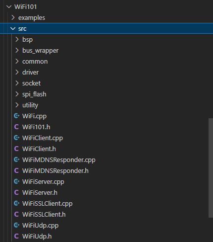

WiFi101 is at first faithfully included as a depenency of the Adafruit MQTT Library
Then this library has the following files

which although it is, during compilation, deactivated (since it’s for RP2040), with the default lib_ldf_mode that does not evaluate #ifdefs (docs), PlatformIO detects an include to WiFiClient.h which it detects in WiFi101, which then triggers that library to built.
You can observe for yourself that if you delete line 26, the build for featheresp32v2 will go through again.
