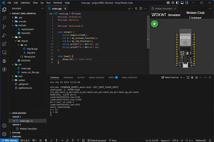

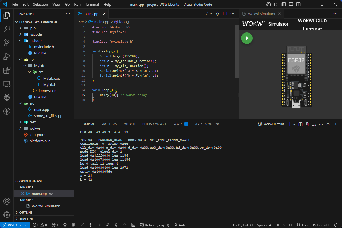

Note: This is about project header files. So instad having your projects header files in the src directory, you can place them into the include directory.
├── include
│ ├── file1.h
│ ├── file2.h
│ ├── file3.h
├── lib
├── src
│ ├── file1.cpp
│ ├── file2.cpp
│ └── file3.cpp
├── test
└── platformio.ini
