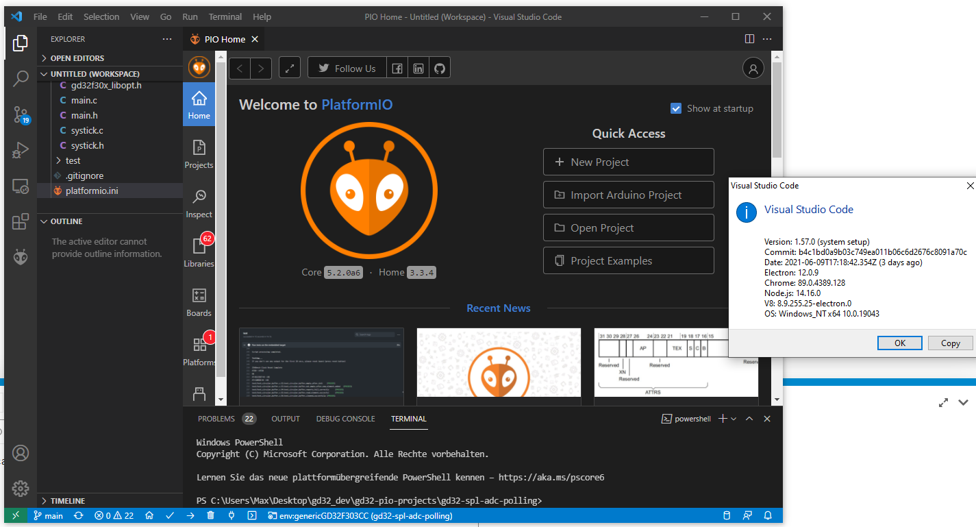

hmm, I’ve lost PIO as well. vscode 1.57.0 says it’s installed,did the delete, closed vscode, restarted vs code reinstalled pio, closed vs code restart but still not being recognized I went through the folder security all looks good but no PIO
You can maybe try a full reinstall of PlatformIO (remove the extension, remove C:\Users\<user>\.platformio, reinstall extension) or look in Help → Toggle Developer Tools → Console if there are any errors.
Otherwise try and disable the trust feature in File → Preferences → Settings.
