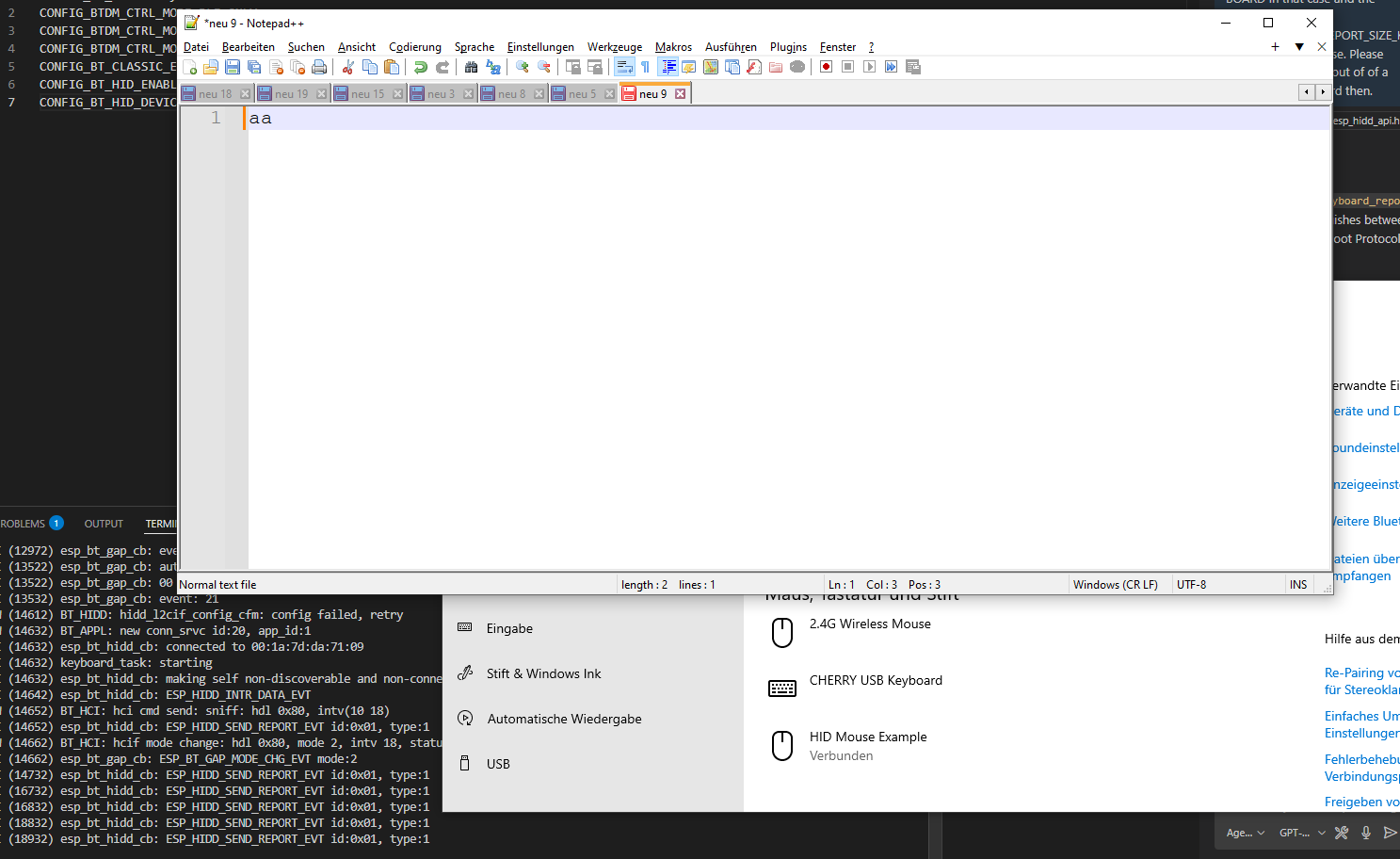

It can pair with my PC perfectly fine and types ‘a’ once every two seconds.
Thanks, I used your project.
It works.
// Task to send HID codes from 0x00 to 0xFF every 2 second

Max Gerhardt took an official example from the chip manufacturer (Espressif)—which was originally designed to work only within the native ESP-IDF environment—and restructured it so that you can easily run it using PlatformIO inside VS Code.
In short, he has “translated” a complex professional example into a format that the community.platformio ecosystem can understand, allowing you to build and flash the Bluetooth HID keyboard firmware without manually setting up the entire ESP-IDF toolchain.
