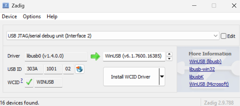

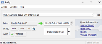

I installed WinUSB on interface 2 in Zadoc to test. But after successfull installation Zadog still shows this (see “Driver:”):

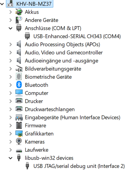

and device manager shows no com 5:
Update:
I even de-installed the libusb-win32 device and installed WinUSB again on interface 2 using a different cable and port. After resetting and putting the S3 into bottloader mode: still the same in Zadic and in device manager…
