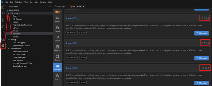

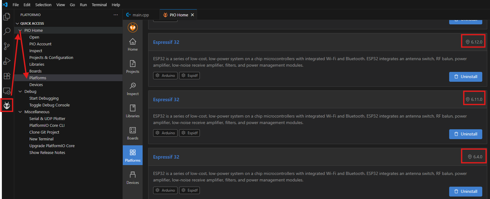

Check if inside the platformio.ini the version is specified like so:
platform = espressif32 @ 6.12.0
If no version is specified, the one installed on your system with the highest number will be used automatically. In this case check the installed platform versions and take a look for the highest available version:
Or take a look at the output during the build process:
PLATFORM: Espressif 32 (6.12.0) > Espressif ESP32 Dev Module
Here you can read “PLATFORM: Espressif 32 (6.12.0)
