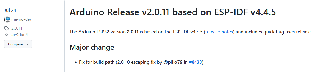

That is correct for your current shown Arduino-ESP32 version of
Since per https://github.com/espressif/arduino-esp32/releases
When using framework = arduino in an ESP32 project, PlatformIO builds the project exactly as in the Arduino IDE: It compiles Arduino-ESP32, and that links in a statically precompiled version of ESP-IDF in the version that is indicated in the releases. These precompiled files live inside the Arduino-ESP32 package, see e.g. here.
