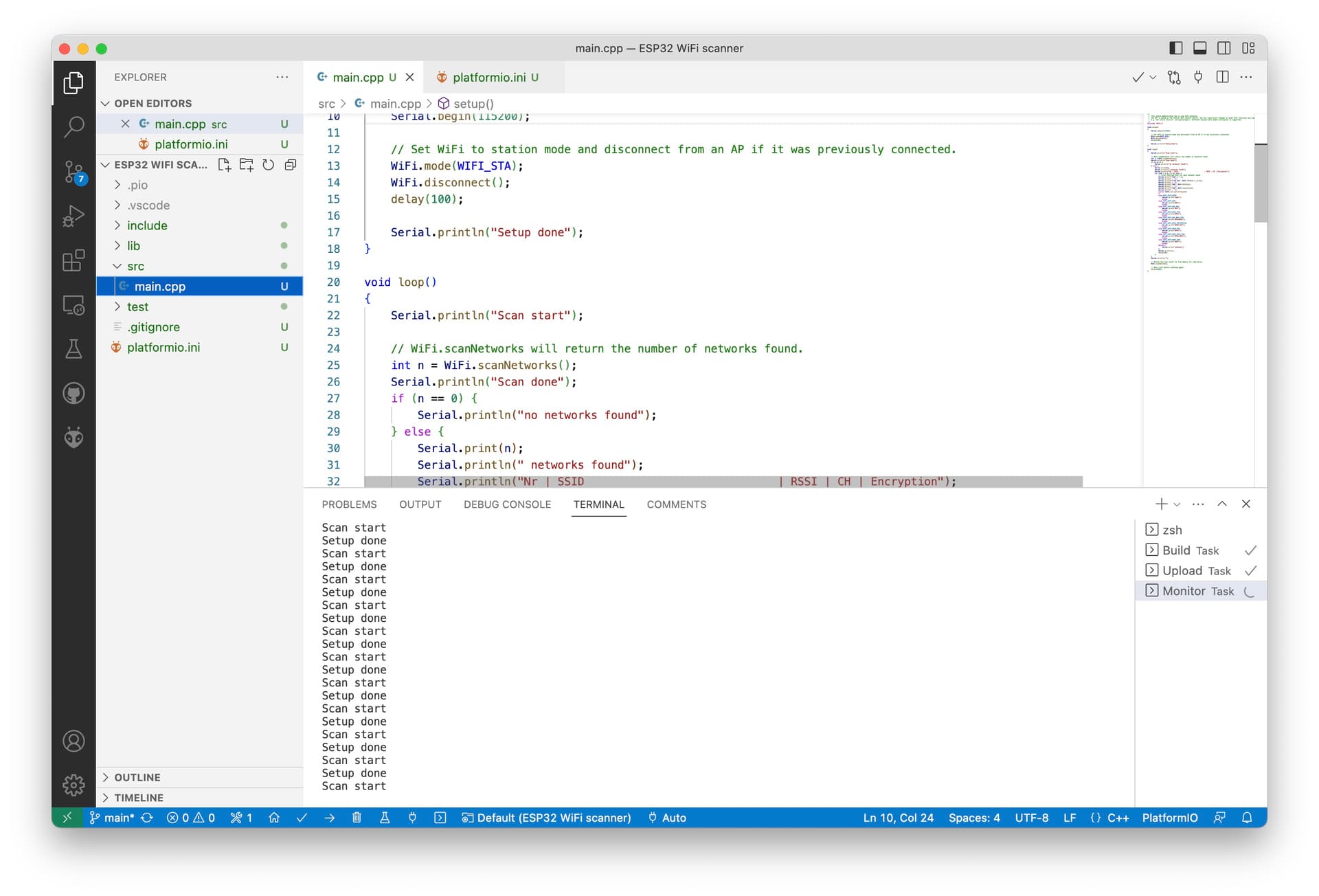

I am using VS Code(1.79.2) with PlatformIO extension (6.1.7). I loaded WiFi Scanner example into my IDE. It compiles and uploads the firmware with no errors but Monitor does not display expected output (according to the logic of the code). Also if I change println statements to display a different message, changes are not reflected in Monitor.

Please show a screenshot of your VSCode with the File Explorer (sidebar) visible.
Okay. So it seems to reboot every time before even outputting a “Scan done”, right?
I get different behaviors from Monitor. Sometimes in produces garbled output. I have to terminate and start it a few times to get it to show output legibly. And when it does, it does not seem to follow the code. In previous screenshot, I expect to see identified networks but I only see ‘scan start’ and ‘scan done’ messages in rapid successions (no delay in between). If I change one of these texts and recompile, I continue seeing the original message not the updated one.

…Usually a ESP32 rebooting when it tries to startup its WiFi radio and send something with it is a power, cable or USB dock / port issue, but okay. What’s your exact platformio.ini and what version of the Arduino-ESP32 core do you have installed in the Arduino IDE? (Tools->Boards->Board Manager → esp32 → version = ?)
Hmm, I did not think of that. That is possible.

I have heard that power can cause garbled output. I wonder why Arduino is working fine on the same hardware. Perhaps it uses different upload mode/speed which draws less power??
Okay, that’s the latest. PlatformIO should also use this core version in a reasonable recent platform-espressif32 version (releases).
