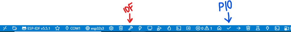

If anyone else is still having this issue and ends up here through google I figured out why I was having this issue.
If you have both platformIO and the espIDF extensions installed you will have two different build buttons one is through the IDF the other through platformIO.
espIDF can’t build a platformIO project without a bunch of make file edits hence this error.
So if you have this error make sure you’re using the PIO build button.
