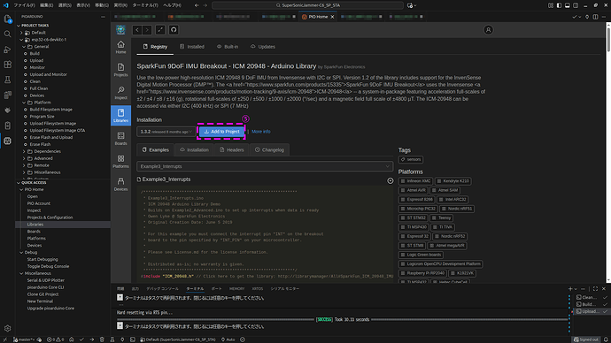

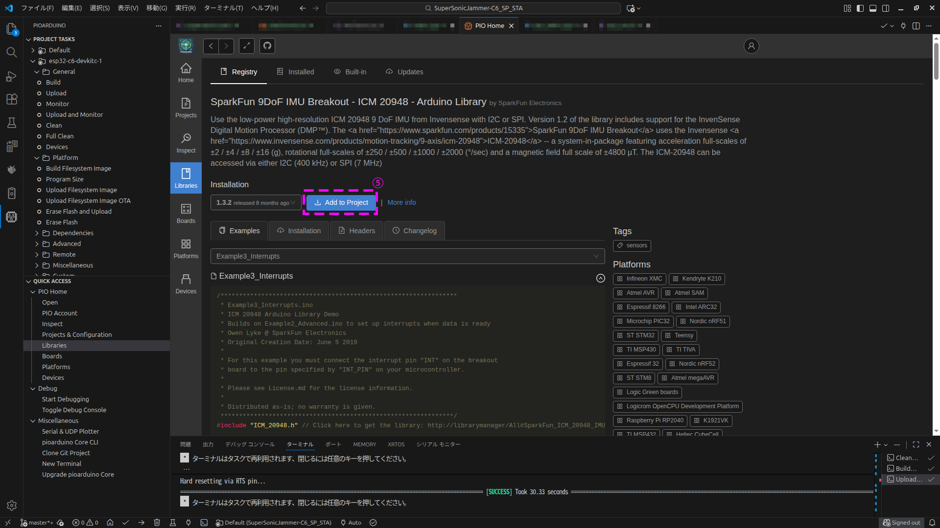

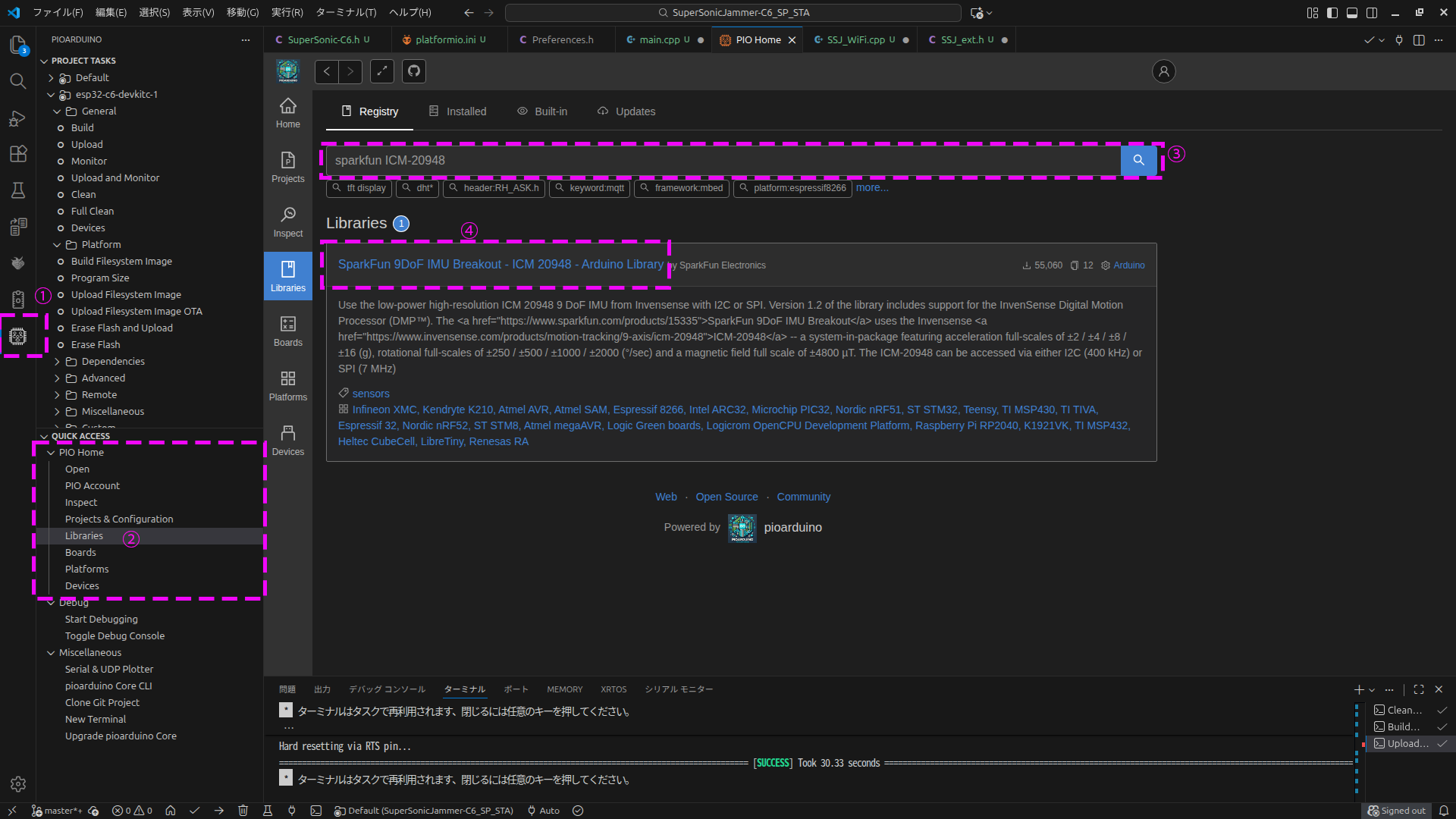

If you did not install sparkfun library yet, you need to install it.
  1. on Activity Bar , click Platformio (or pioarduino: on attached image)
  2. click “PIO HOME” → “Libraries”
  3. serach sparkfun ICM-20948
  4. click found library title name
  5. confirm contents and click “Add to Project”
Hi Ito_Giken. - I installed the library that you referenced but it seems not to have solved my problem. But thank you for the suggestion anyway. - Jim

Sorry, I didn’t notice that the include file name was different.
As sIvar2311 pointed out, you need to change include filename.
