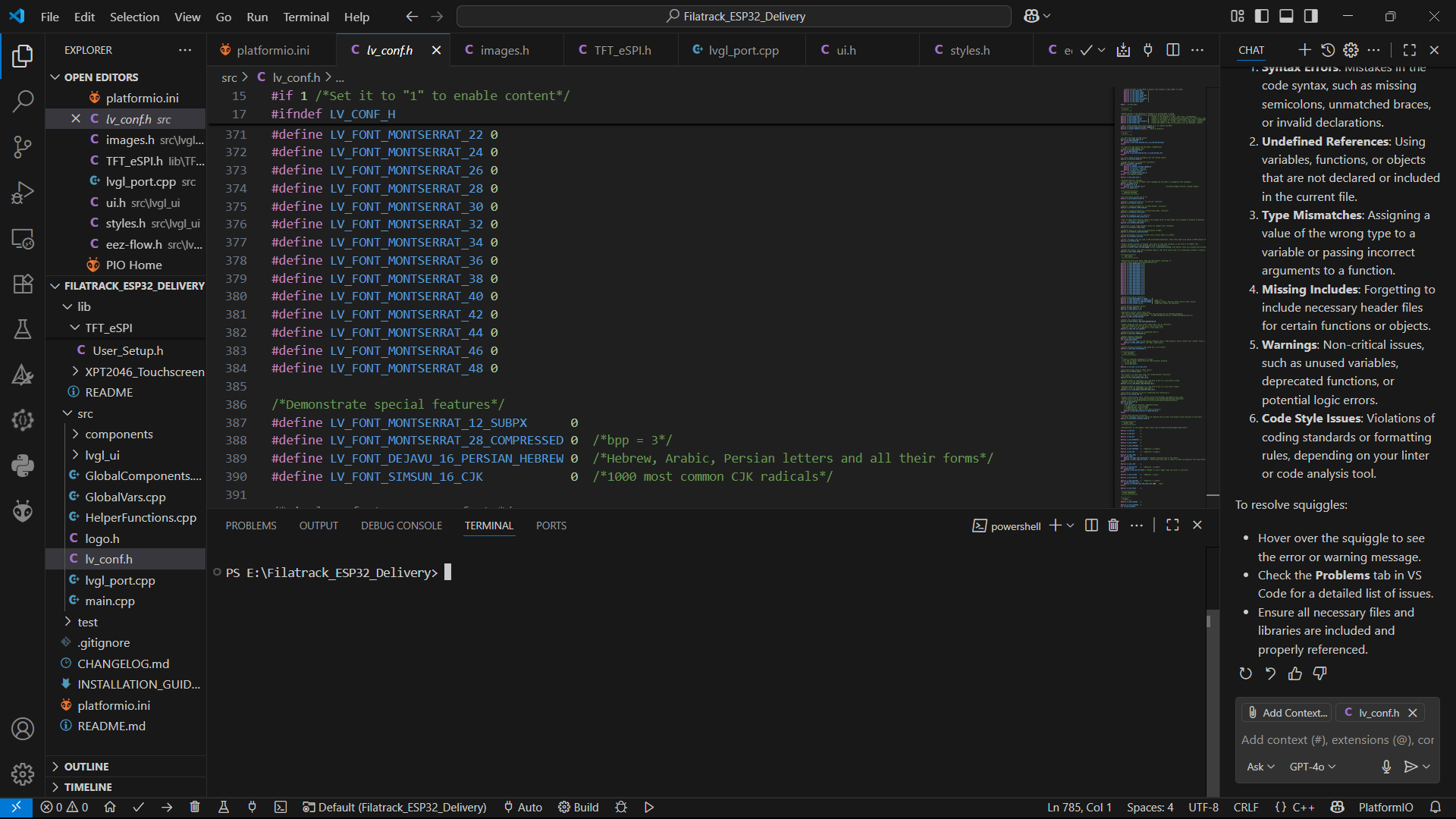

Here is my platformio.ini file:
[env:esp3dev]
    lvgl/lvgl@^8.3.11        ; Lock to LVGL v8 for compatibility
    TFT_eSPI                 ; Display driver
    XPT2046_Touchscreen      ; Touch controller
    Arduino_MFRC522v2        ; RFID reader
    HX711                    ; Weight sensor
    PubSubClient             ; MQTT client
    ArduinoJson              ; JSON handling
    -I src
    -I src/lvgl_ui
    -D LV_CONF_INCLUDE_SIMPLE
    -D USER_SETUP_LOADED
    -D DEBUG
monitor_speed = 115200        ; Serial monitor baud rate
Here is the full error log from the terminal when I try to build:
