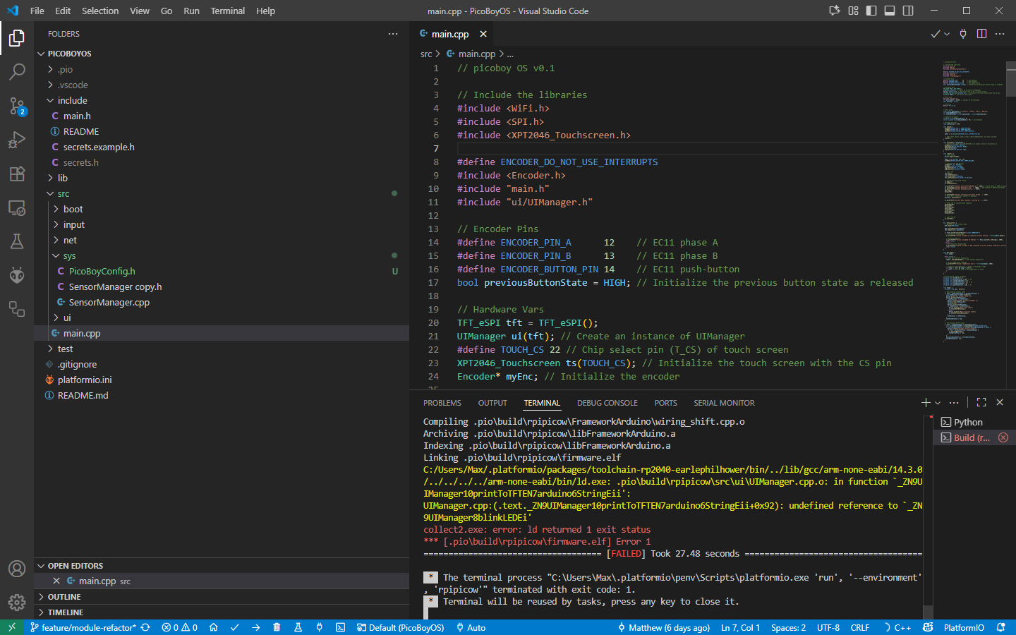

Hi all, very new to PIO in general, just moving here from the Arduino IDE.
I’m not too sure on what’s causing this - I’m using the platformio.ini suggested by Max, here.
Here’s my build output:
 *  Executing task: C:\Users\Matt\.platformio\penv\Scripts\platformio.exe run
Processing rpipicow (platform: https://github.com/maxgerhardt/platform-raspberrypi.git; framework: arduino; board: rpipicow)
CONFIGURATION: https://docs.platformio.org/page/boards/raspberrypi/rpipicow.html

In file included from C:/Users/Matt/.platformio/packages/toolchain-rp2040-earlephilhower/arm-none-eabi/include/stdlib.h:18,
                 from C:/Users/Matt/.platformio/packages/toolchain-rp2040-earlephilhower/arm-none-eabi/include/c++/14.3.0/cstdlib:79,
                 from C:/Users/Matt/.platformio/packages/toolchain-rp2040-earlephilhower/arm-none-eabi/include/c++/14.3.0/stdlib.h:36,
                 from C:\Users\Matt\.platformio\packages\framework-arduinopico\cores\rp2040/Arduino.h:24,
                 from lib\TFT_eSPI/TFT_eSPI.h:30,
                 from src\ui\UIManager.h:4,
                 from src\ui\UIManager.cpp:1:
C:/Users/Matt/.platformio/packages/toolchain-rp2040-earlephilhower/arm-none-eabi/include/sys/reent.h:169:28: error: expected identifier before '*' token
  169 |   _READ_WRITE_RETURN_TYPE (*_read) (struct _reent *, void *,
C:/Users/Matt/.platformio/packages/toolchain-rp2040-earlephilhower/arm-none-eabi/include/sys/reent.h:170:52: error: '_READ_WRITE_BUFSIZE_TYPE' has not been declared
  170 |                                            char *, _READ_WRITE_BUFSIZE_TYPE);

I have no idea why they’re causing the issues, they must be but I just cannot pinpoint the problem, CPP is still somewhat new to me so please go easy on me! Also apologies if this is in the wrong place, feel free to move it admins if need be :slight_smile:

I made the repo public here: GitHub - mattordev/PicoBoyOS at feature/module-refactor but I can upload it directly in a zip if you like :slight_smile:
The most confusing part to me is, it builds fine on develop, but since trying to refactor, it HATES it.

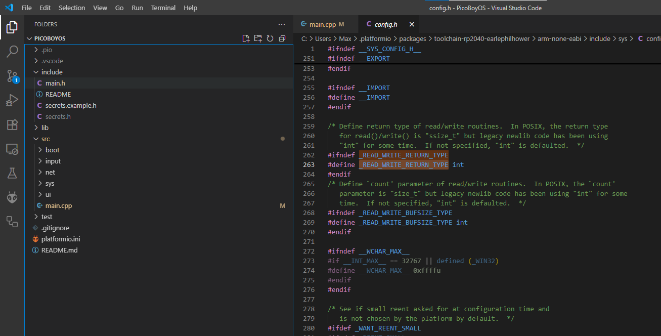

You’re having a file called sys/Config.h. This is extremely deadly. The compiler’s newlib C library’s configuration file is called sys/config.h, which is where the missing _READ_WRITE_RETURN_TYPE is located.
With the file simply renamed, it only has a linker error for a missing function.
I guess you could also change the folder name sys to something else to avoid the nameclash here with the compiler sys stuff.

The linker error comes from the function
UIManager::blinkLED(int)
not being implemented yet.
You’re a lifesaver Max, seems like such a rookie error :frowning: but we have to learn at somepoint!
And ah, that linker error is just due to me shifting around my function for blinking the Picos LED - it was originally in the UIManager but it didn’t make much sense, so it’ll probably go somewhere in /src/sys
I’m definitely going to move the TFT flags to the INI though, seems like a no-brainer. I don’t suppose there’s anyway around manually putting in the forked encoder library?
