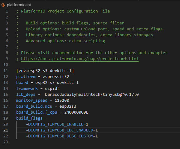

and I change the platformio.ini to observe this library dependency

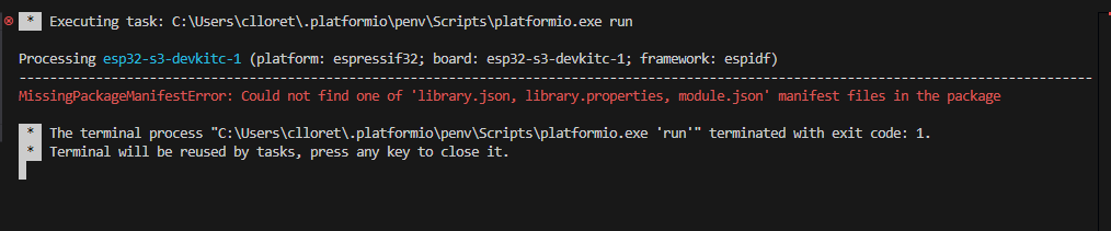

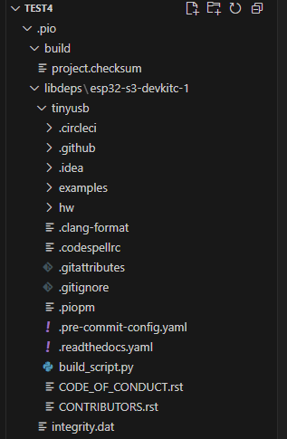

The moment I add the library dependency this causes this error:
lib_deps
and framework = espidf
do not mix together well at all. (issue). You should be using the components folder or the Espressif component registry together with a idf_component.yml

Equally, you should not be using build_flags
to configure your ESP-IDF / components setting. Use the sdkconfig.defaults
file to setup default options like the example
and remember to delete the .pio
and sdkconfig.<environment name>
file for a full clean rebuild under the new settings.

I add this flags into the sdkconfig.defaults and I remove the build flags and the lib_dep from the platformio.ini.

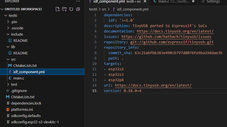

→ I erased the .pio folder
→ I removed the lib_dep
→ I changed from the sdkconfig.esp32_s3-devkitc-1 to sdkconfig.defaults

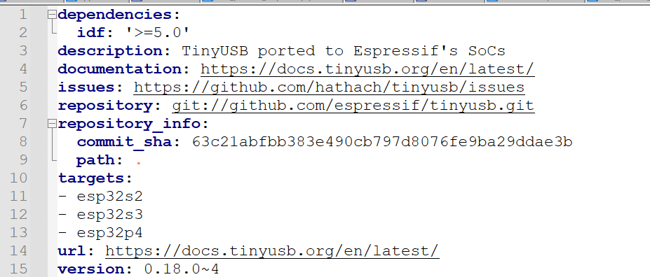

→ I added the change in the idf_component.yml…

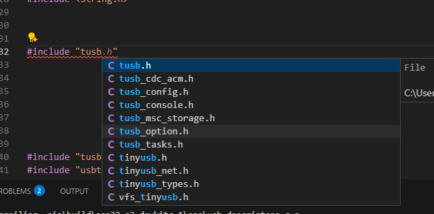

but in the main.c there are no tinyusb suggestion… why how can I solve it?
No? Just as per the linked example,
You have to press the “Build” button for the intellisense to update and give you suggestions. (Or Ctrl+Shift+P → Rebuild Intellise Index).

IDF Component Manager Manifest File
dependencies:
espressif/tinyusb: “^0.18.0~4”
idf: “^5.0”

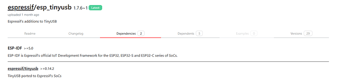

esp_tinyusb
has some pretty important integration code for TinyUSB, like starting up the USB PHY, creating the TinyUSB processing task (tusb_device_task()
), registering the callback functions for the CDC, et cetera. Sure, you can do it with just tinyusb
, but you’ll end up writing just another version of the esp_tinyusb integration code, I think.

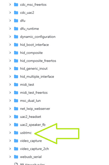

The reason because of my early choice is the fact that the tinyusb has an example with usbtmc. USBTMC stands for USB Test & Measurement Class.

Interesting, because in the USBTMC example, the espessif family is explicitly in the “skip” list, indicating it’s not directly compilable for it.
You’ll have to adapt the example anyway because of stuff like app_main()
being the entry point instead of main()
, et cetera. Let me just have a look at compiling and running that example for an S3.

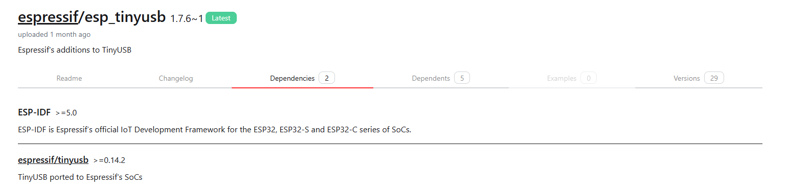

I will use both. In fact according to the component register esp_tinyusb is dependant of the tinyusb.

Good news:
I am able to add the tinyusb component: in fact a new folder is created once I clean and I build the project. The suggested managed code appear when I include a new library.
I am almost done.
→ I was able to install and use the components.
→ The suggested code is shown and I am able to use the components.
