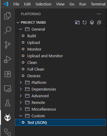

I actually don’t see a way to force the regular “pio test” command to use JSON output from within the platformio.ini.
I think the best you can do is create a new project task, that will show up in VSCode, too.

This is then also executable as pio run -t testjson.
thanks, I introduced a small change to your script
Import("env")
env.AddCustomTarget(
    name="testjson",
    dependencies=None,
    actions=[
        "pio test --json-output-path=test/logs -v -e \"" + env["PIOENV"] + "\"",
    title="Test (JSON)",
    description="Run unit tests with JSON output"
test/logs to test/logs
to make sure the directory that is picked is relative to the project (my original intent).
it works.
