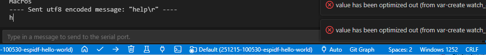

The messages in the terminal window do not match the settings
utf8 where it should read Window1252
help\r where it should read \r\n
Furthermore does it seem that my esp32-s3 board always receives a \n even when i specify \r or \r\n.
We have absolutely zero clue what’s going on there if we don’t see the platformio.ini and the project source code.
Also the “Type in a message to send to the serial prot” makes it seem like you’re using a different Serial Port extension, and not the “Monitor” project task which would launch pyserial / miniterm.

Seems to be my error, it seems it’s the Microsoft’s Serial Port Monitor i have issues with (I’ll recreate this issue there).
