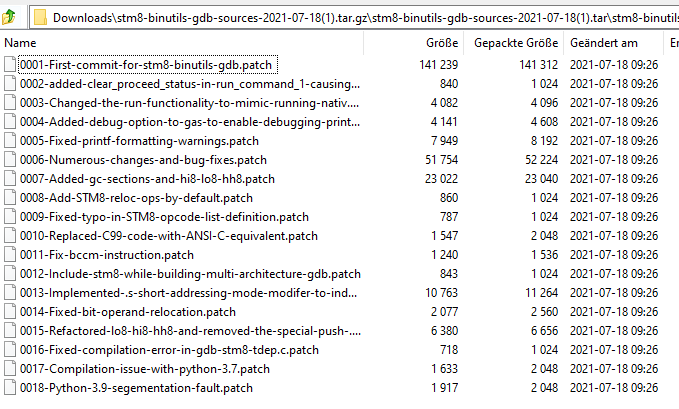

There also seem to be genuine newer versions of stm8-gdb available at https://github.com/spseol/STM8-binutils-GDB, although they seem a bit vibecoded.
The latest version of the original stm8-gdb is from 2021, while the one in the reigstry is the 2018 version. https://sourceforge.net/projects/stm8-binutils-gdb/files/. It apparently uses Python 3.9.
