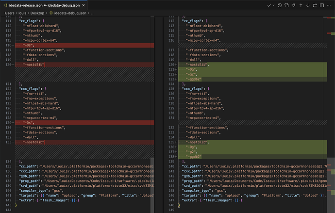

I noticed that when I remove the build_type or set it to release, the upload works fine but the mcu crash.
I check the diffs between the flags according to the build_type and the differences look like that
So I tried to add -Og -g2 -ggdb2 flags to my platformio.ini build_flags but hat doesn’t change anything, the mcu crash.

You need to at least build_unflags = -Os to properly do that, otherwise it will have both -Og and -Os.
