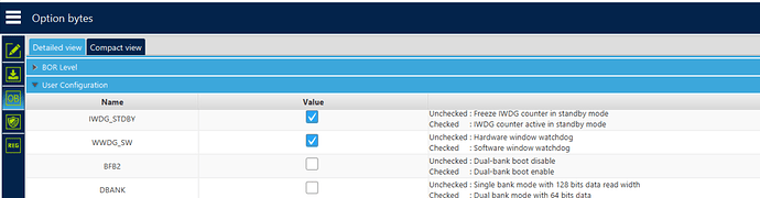

fail to download code to STM32G474CBT6 flash. yet download code to G474RE successfully.
Error: write into gap from 0x08010000 to 0x0803ffff

Warn : Adding extra erase range, 0x080119c8 .. 0x080407ff
Error: error writing to flash at address 0x08000000 at offset 0x00000000
embedded:startup.tcl:1516: Error: ** Programming Failed **
