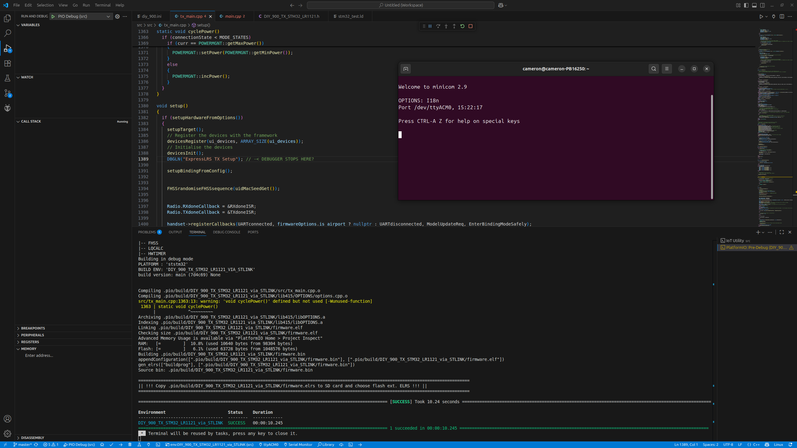

Hello, Im looking for help related to getting any output to show in serial output. Im flashing ExpressLRS firmware from there last supported STM32 release (version 3.4). They use DBGLN and my program keeps getting stuck or halted here. Im trying to test tx functionality but im not sure how packets are being sent or what im supposed to be seeing in serial output. Building and uploading are succesful when I use platform io and upload through st link.

Here is a screenshot of me in debug mode halted at DBGLN and the terminal is using minicom but serial output on pio shows nothing as well:

So when I try anything like DBGLN(“ExpressLRS TX Setup”); it just halts.
So if its building and uploading I think my linker script is fine. The header file I include is for pin layout and macro defines.Overall, Im not sure If its something as simply as i need to restart my board each time I upload or open serial port right after upload Im still learning about mcus. Or if I need to look over the logging.h file.

Yeah I posted on their discord as well and wanted to see if maybe anything looked wrong within my ini file or anything platform.io related that could cause this. So wanted to give some project specifics
If you want a sanity check that your serial output is in principle working on your Nucleo L476RG, then I suggest creating a new blank project for Nucleo L476RG with framework “Arduino”, that should give you
[env:nucleo_l476rg]
platform = ststm32
board = nucleo_l476rg
with src/main.cpp code
  Serial.begin(9600);
  Serial.println("Teeeest");
  delay(1000);
“Upload and Monitor” that, at the default 9600 baud.
