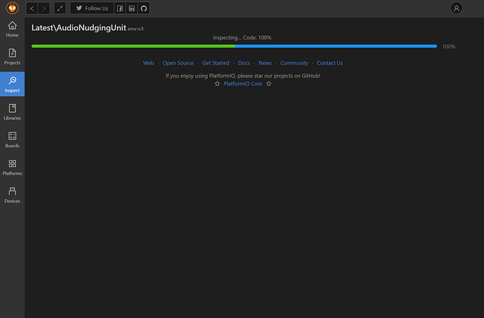

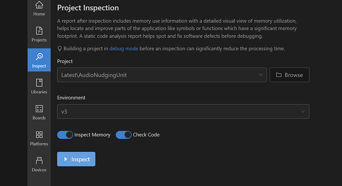

and want to run static code analysis using the graphic user interface here

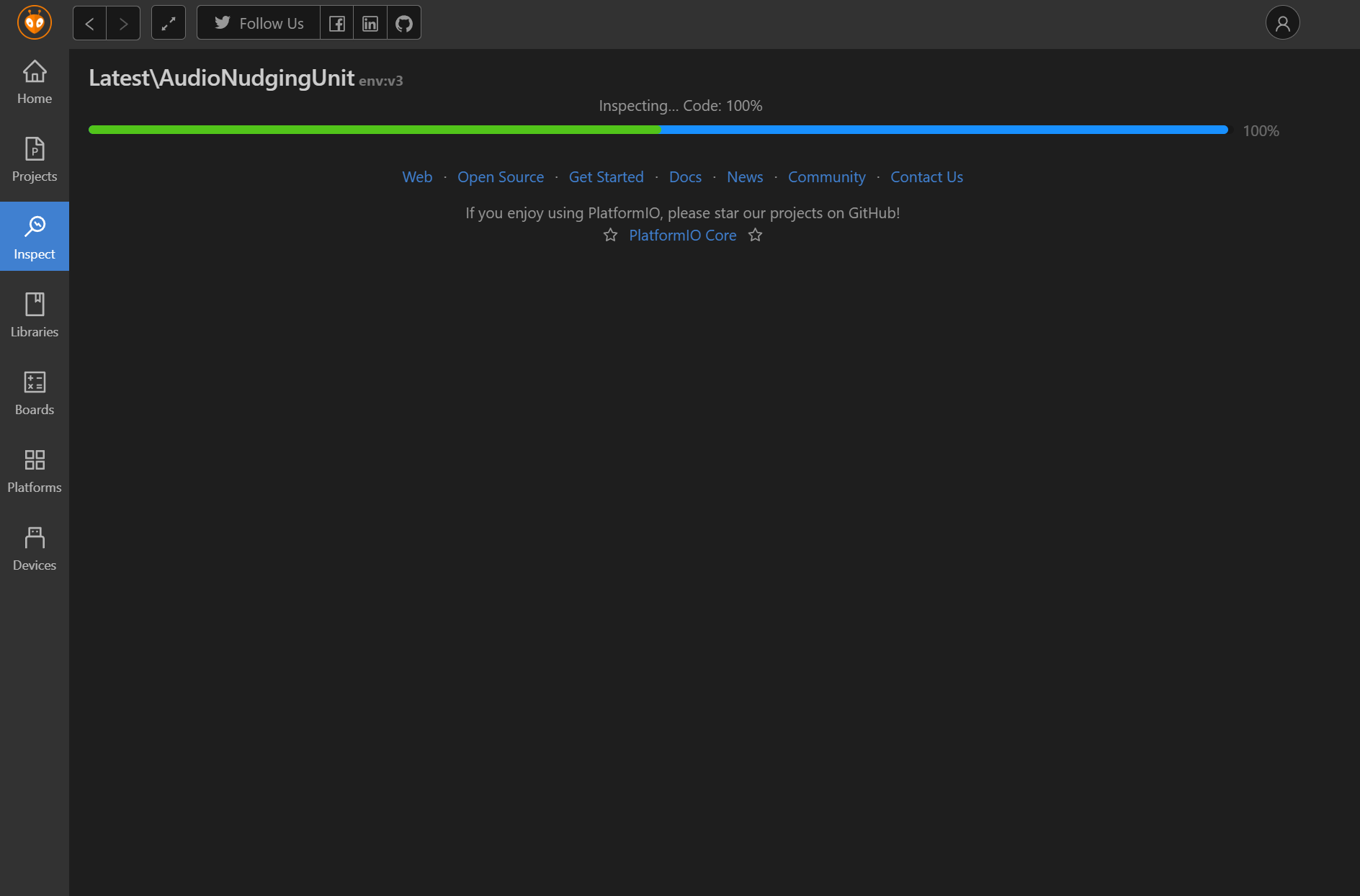

When I press the Inspect button I just ends up with a progressbar at 100% after some time. See here:
Why dont I see a list of defects as described here:
https://docs.platformio.org/en/latest/advanced/static-code-analysis/ui.html#
…I dont believe it is because there are none :slight_smile:

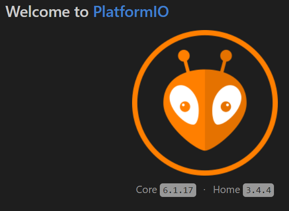

…and the version of PlatformIO should be the latest one:
