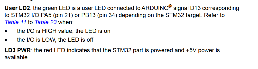

Are you sure? If a certain solder bridge is not set, it’s at PB13 instead.

Yeah im stupid, got too caught up on finding the right IDE and making it work that it didnt even cross my mind that a basic generated code could possibly not work, thank you
