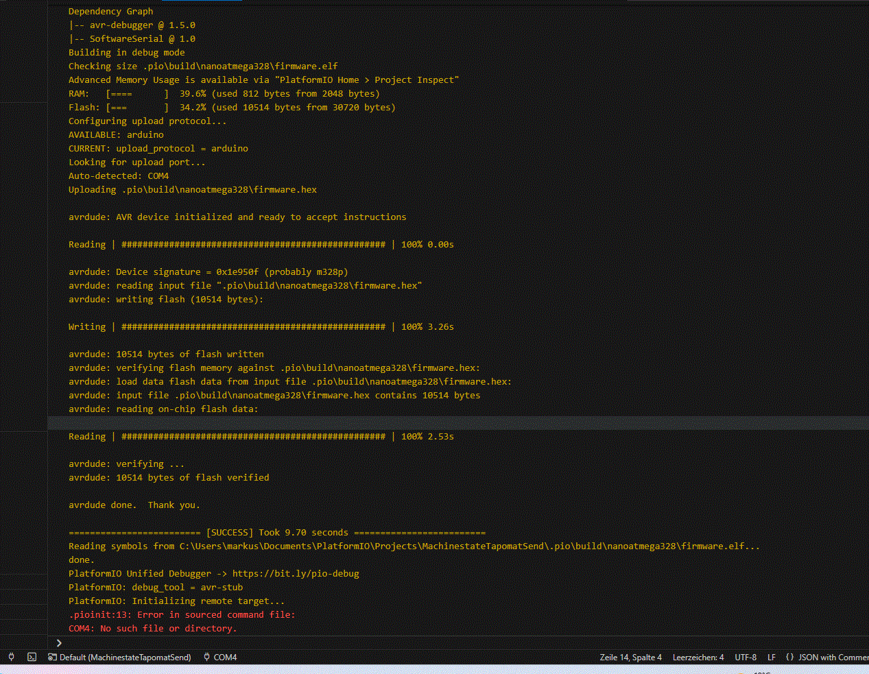

I did the same, compiling was ok, but when I start PIO Debug I get the error with the COM-Port that there is no File … I have no idea what that means, there are a part of the output:
PlatformIO Unified Debugger -> https://bit.ly/pio-debug
PlatformIO: debug_tool = avr-stub
PlatformIO: Initializing remote target...
.pioinit:13: Error in sourced command file:
COM3: No such file or directory.
Have someone an idea, what to do?

Well, GDB says COM3 doesn’t exist.

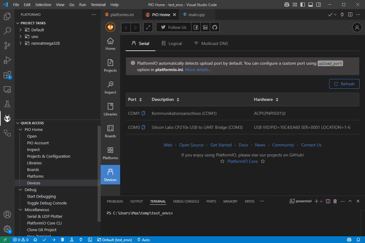

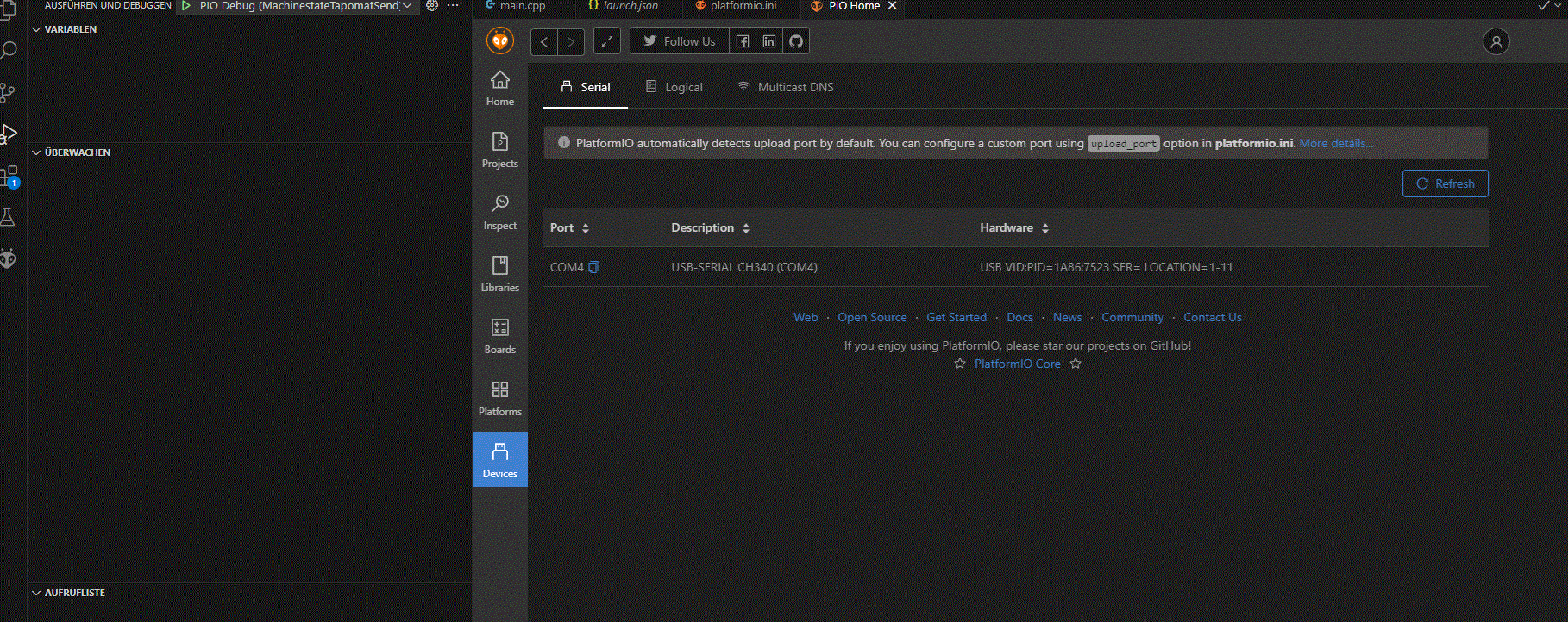

Can you show a screenshot of the PlatformIO “Devices” view when the Nano is plugged in?

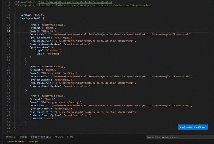

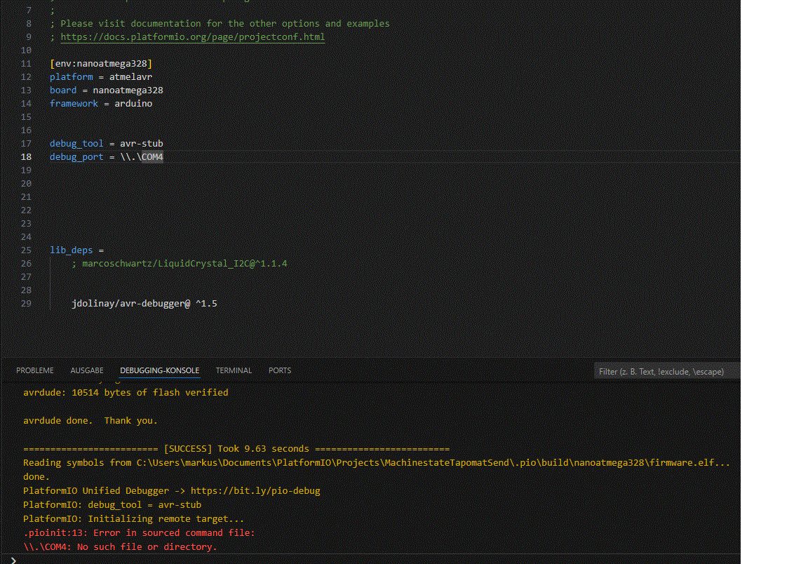

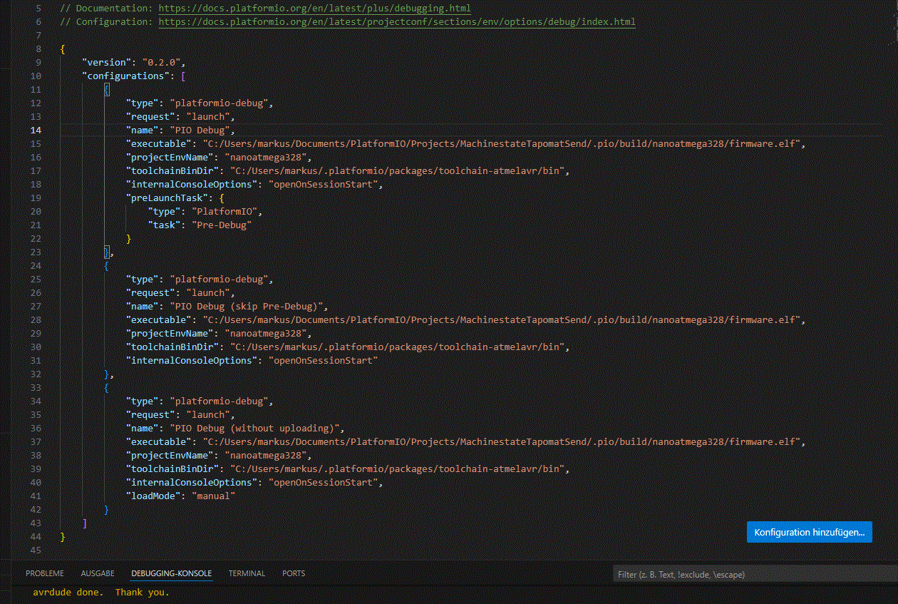

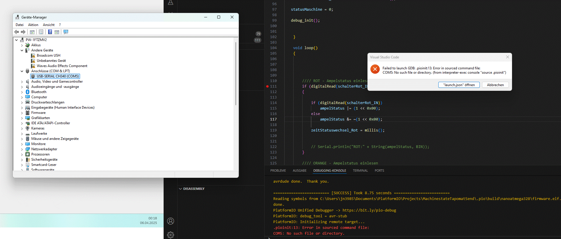

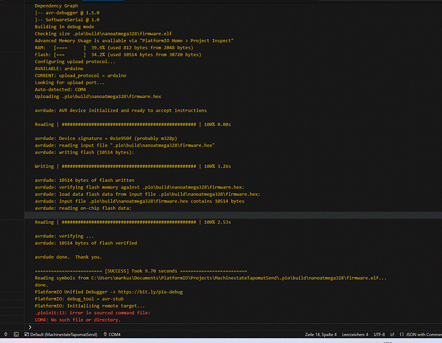

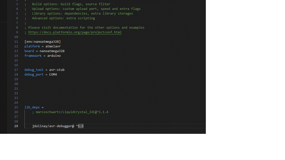

Hi Gerhard, I started again, with another Port, same Issue, there are some screenshots. What is the matter, are there maybe changes in the controller 328 ??
Can you put the debug port as
debug_port = \\.\COM4
instead?
It’s the same … see screenshot

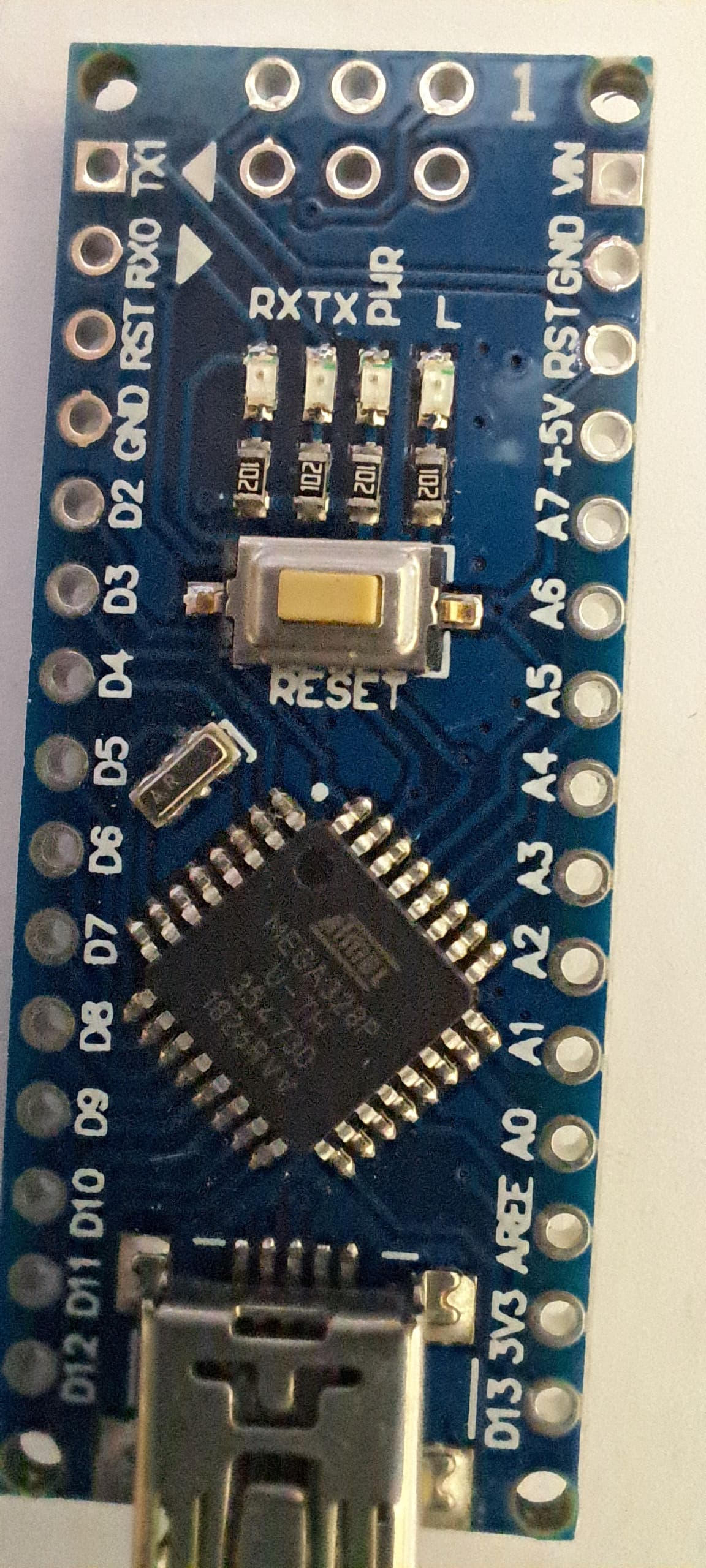

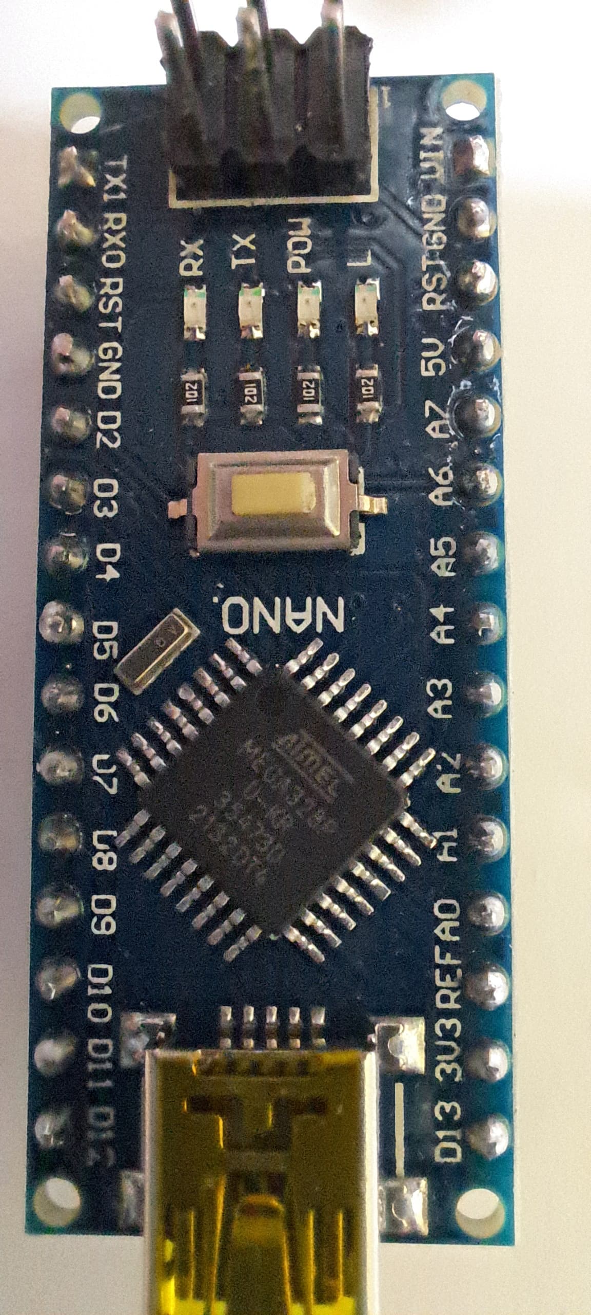

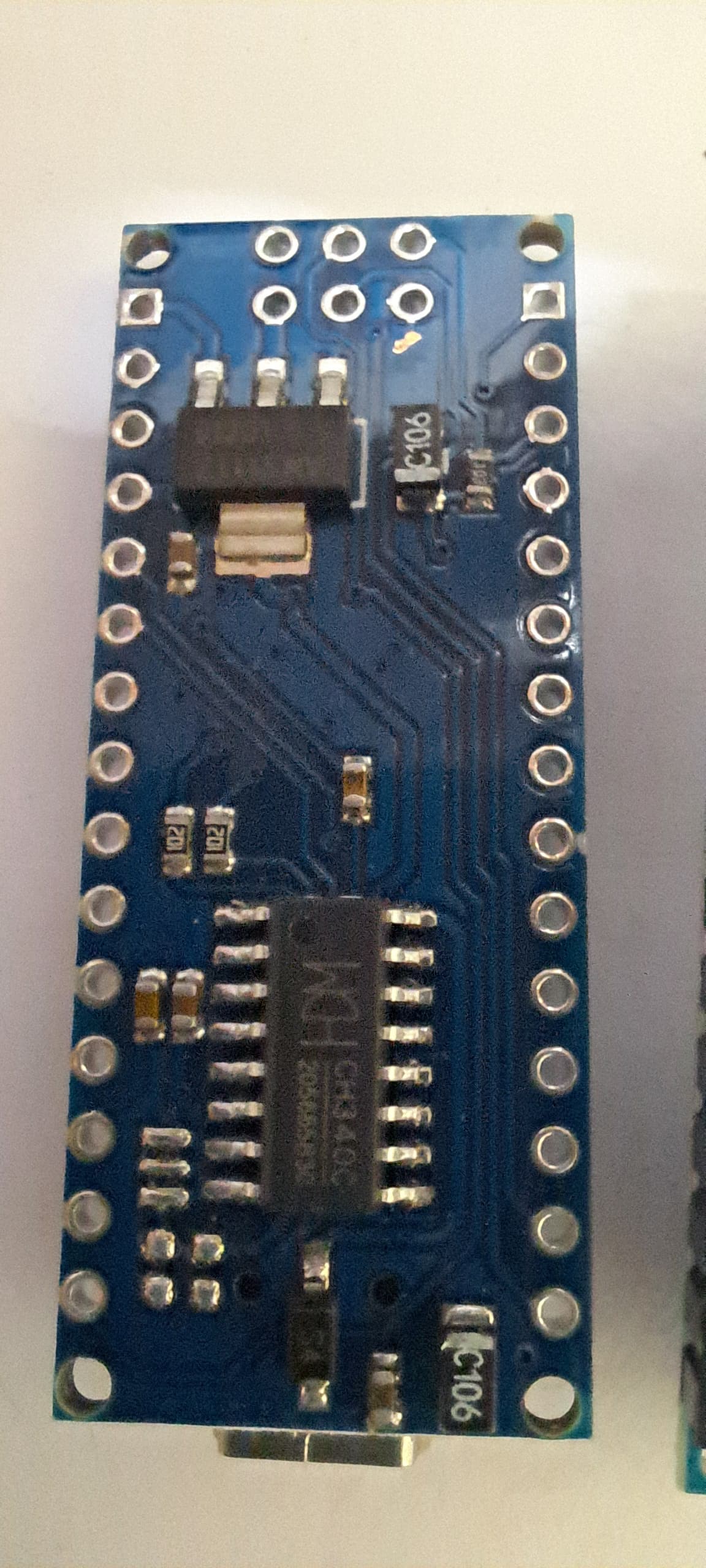

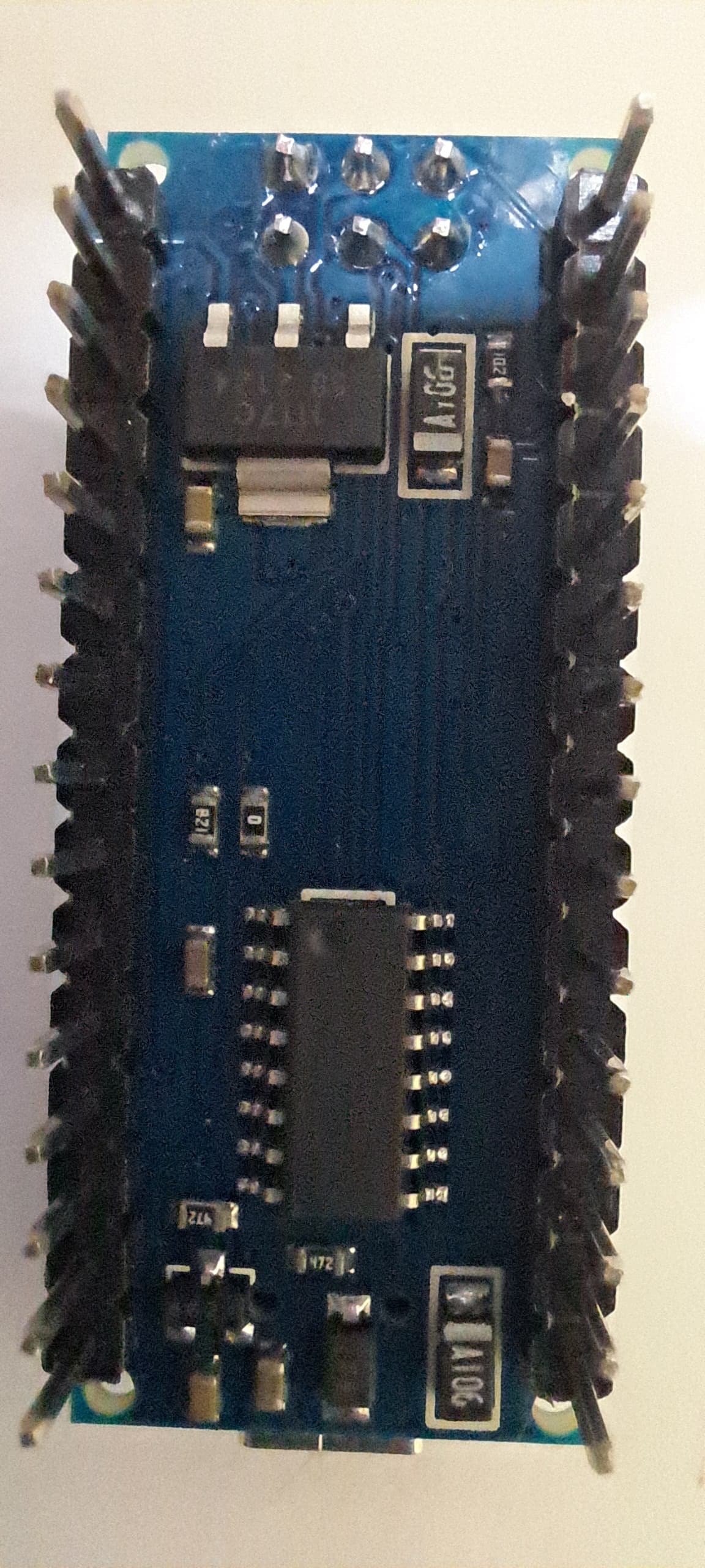

Hi, I tested another Controller, he was good. I think there is something with the Controller. But all ok, only debuging is a problem. Do you have an idea? Here are pictures.
That’s odd. It’s almost as if the COM port disappears for a few moments after the upload is complete. Can you confirm that by opening the Windows device manager and keeping a watch on the “COM ports” section as debugging starts up?

There is no special antivirus software. I tink there is a problem with a setting at the board. With another board (also Nano) is it working.
Strange. Can I read some information about the board which could help us?
…So for uploading, the device stays as COM4, but after uploading, it becomes COM5?
No, the port COM5 is staying the same, he doesn’t change, neither in device manager and nor in the PIO. It’s staying at both.
I have an other controller from the same order. He has the same problem. All things are working, but only the debugging doesn’t work.
What could be the reason for them?
Nobody have an idea what could be the difference of the boards. Both from China. The only problem is the debugging … could be there another config in the hex - file or something?
