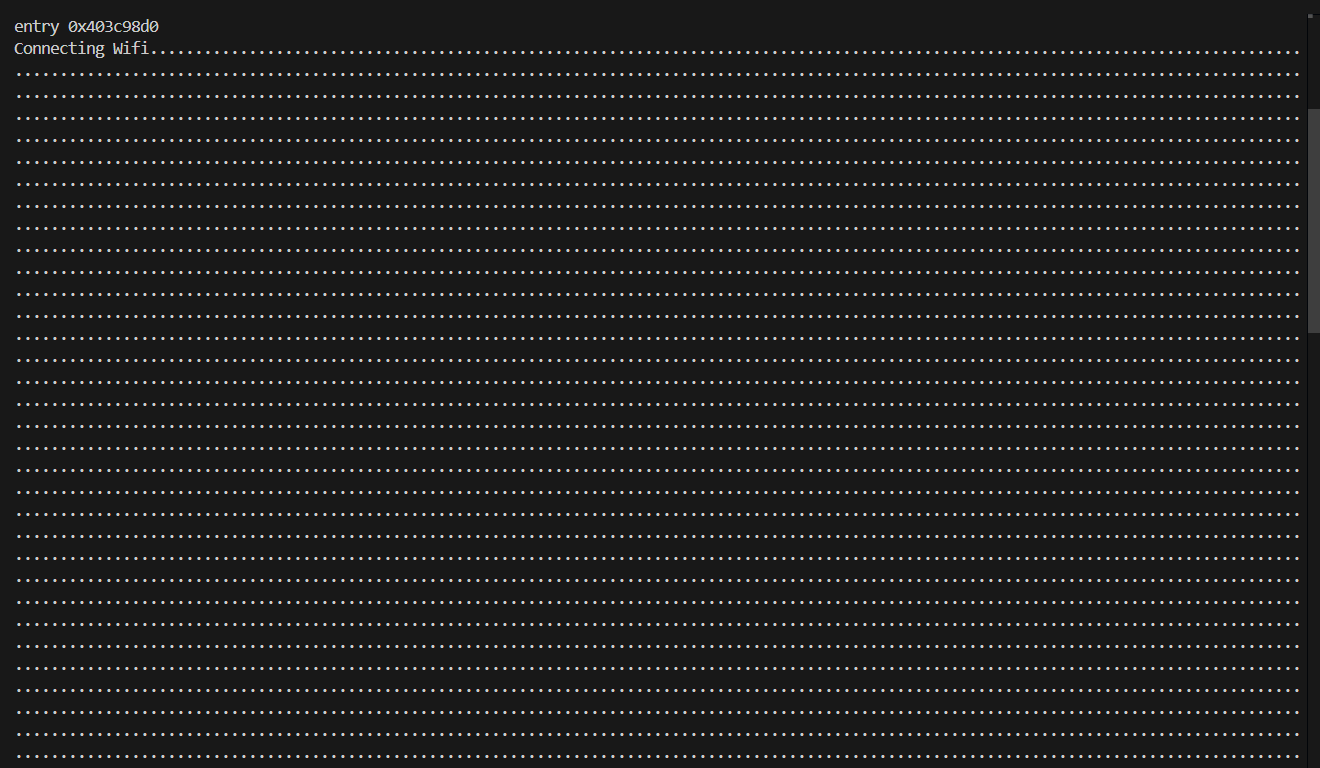

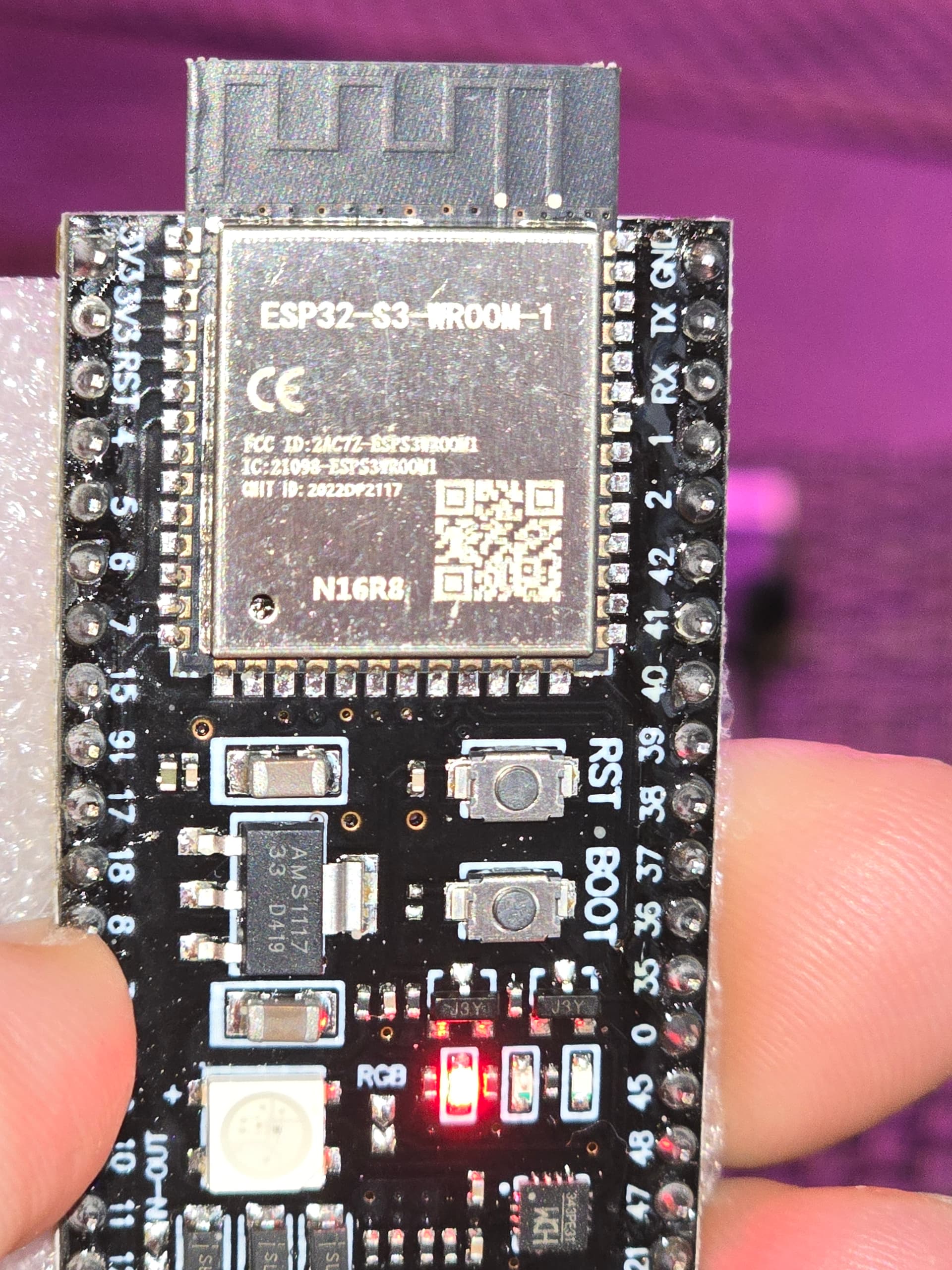

I’m still fairly new to esp but I’ve read through every relevant source on the subject and can’t get it work, I’ve tried 3 of my boards and some seem to work better than others but still not really. I don’t get any errors and my serial monitor and RGB works as a wifi status indicator, but it rarely connects, I just get WL_Disconnected (6).

Unfortunately, still the same result on 2 of my boards after 10 minutes, no connection on either my home router or hotspot on 2.4 GHZ.

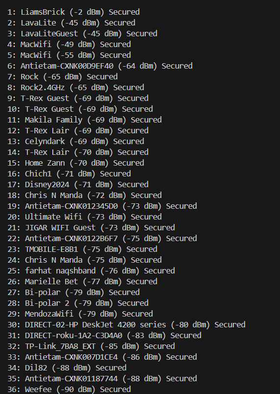

Did you try a wifi scan sketch?
Yep, and interestingly they are there at the top

I have 3, when first testing the 2 that I didn’t solder the rgb seemed to have more success so I thought it might be a power draw issue as mentioned other forums where they are powering servos but you’re right, it doesn’t seem to be that.

I am glad you found the solution. Just wondering whats going on.Looks like your boards are of poor quality. I had similar issues with a ESP32-S3 fake module where the PCB antenna was of poor quality.
I remember there is a way to fix the antenna by soldering a short piece of wire to a specific point.
