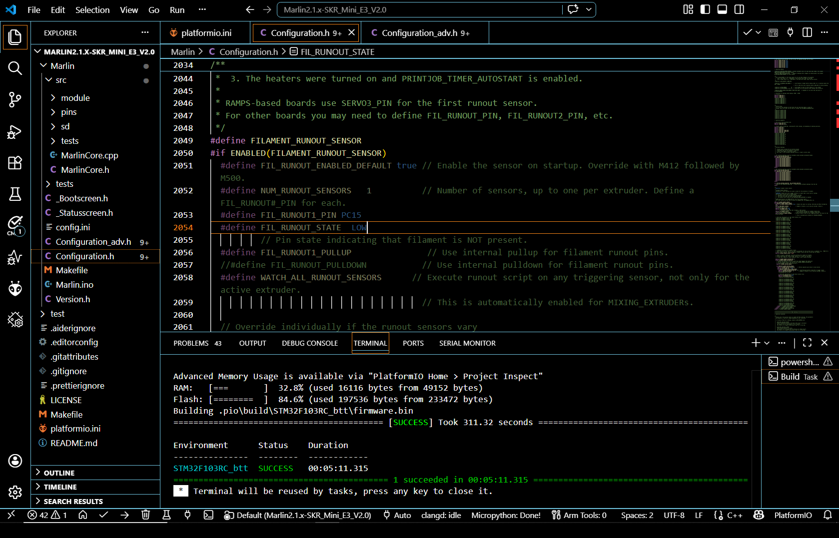

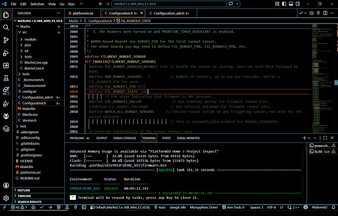

I am using platformio with VS. I am having an issue when platformIO loads in VS it over takes my VS editor settings to keep lines of code from dimming for whatever reason somebody wouldn’t want to see their code for, doesn’t matter I find it incredibly unuseful. I’m using a darkmode with high contrast because it’s easier on the eyes after staring at it for hours, but with the dimming/fading of lines for hierarchy or whatever I can barely see the lines even when the line is in focus while editing the line. I deactivated this nuisance in VS, but can’t figure out how to stop it when using platformio. I searched online for answers and tried AI for answer but had no luck. The only solution I have right now is to edit without platformio and add it in when I’m ready to compile, but that is obviously a nuisance itself , but at least I can see what I am working on.

It’s is a little darker on the screen then the screen shot turned out, making it harder to read.
I fixed it, I disabled platformio in the extensions then reenable it. This forced the meta something to rebuild and afterwards I can see everything.
