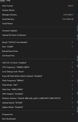

Here’s what I’ve tried in platformio.ini:
;SERVO DOES NOT MOVE
;[env:esp32-c3-devkitm-1]
;platform = espressif32
;board = esp32-c3-devkitm-1
;framework = arduino
;lib_deps = madhephaestus/ESP32Servo@^3.0.8
board_build.mcu = esp32c3
board_build.f_cpu = 160000000L
    -D ARDUINO_USB_MODE=1
    -D ARDUINO_USB_CDC_ON_BOOT=1
    -D ARDUINO_ESP32C3_DEV=1
    -D CONFIG_DISABLE_HAL_LOCKS=1
    -D ESP32_C3=1
    -D BOARD_HAS_PSRAM
    -D ARDUINO_FLASH_MODE_QIO=1
    -D ARDUINO_FLASH_FREQUENCY=80
    -D ARDUINO_PARTITION_DEFAULT_4MB=1
upload_speed = 921600
My question is:
What am I missing in the PlatformIO setup that prevents this exact same code from working, even though it runs fine from the Arduino IDE?
Thanks in advance!
