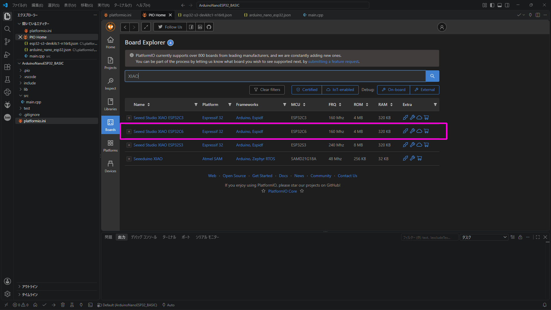

If you search for “XIAO” under “PIO HOME” > “Boards” in VS Code, it should appear as shown in the attachment.
