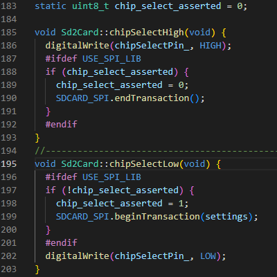

You see in the official library code,
It already has provisions for accepting an externally set SDCARD_SPI macro value. In the not-defined case (#ifndef) it defines that macro to its fallback value of SPI. And since nothing else in this library defines SDCARD_SPI, this is the default case when no additional options are set. Meaning that if build_flags = -D SDCARD_SPI=SPI1 is set in the platformio.ini, that macro will be defined, to SPI1, and the correct SPI object will be used in every code that references SDCARD_SPI, i.e., the code below.
^-- Writing to this register of the SPI1 peripheral will trigger action on the microcontroller’s hardware SPI1 pins, as listed in the datasheet.
The SD card library has no idea what the SPI pins are in the current configuration and it does need to. It delegates the work to the SPI(1) library and just calls SPI1.transfer(). The SPI(1) library code is then responsible for righting to the right hardware peripheral registers which will trigger actions on the hardcoded / hardware SPI pins.
The only pin the SD library explicitly knows about is the chip select pin you give it. It saves that in the SD.init() call in its chipSelectPin_ member variable and later on uses regular digitalWrite() on it.
