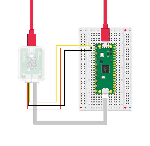

I’m assuming it’s not a hardware issue as the 3 wires from the debug go straight to the Pico as in the documentation
so it’s more likely to be a software/config problem? Does anyone have experience with this setup?
