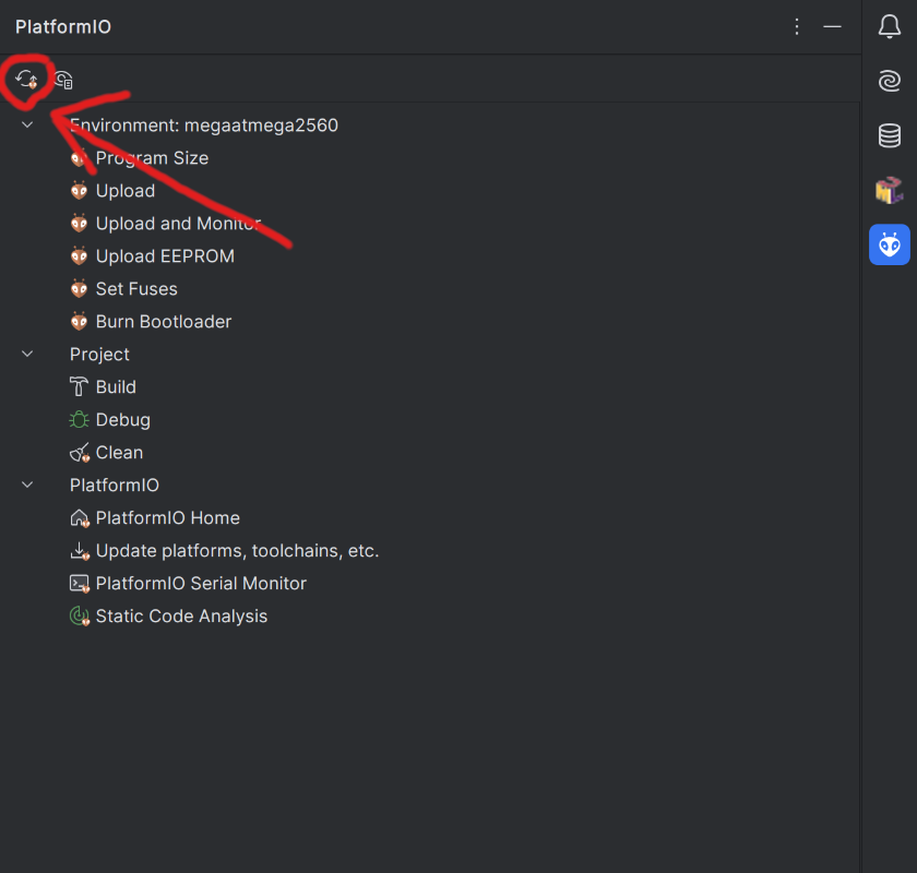

CLion only performs such actions in included files. The blue square in the icon of the file indicates that it is included. I assume that the only included file in your project is main.cpp, which is why refactoring only works there (not sure why it does work in headers).
In PlatformIO, the way to include your source code is by opening up the PlatformIO sidebar and clicking the “Reload PlaformIO Project”.
Alternatively, you can also right click on a file and go to PlatformIO > Reload PlatformIO Project.
You should do this every time you add a new source file to your project.
Please let me know if this helped.
