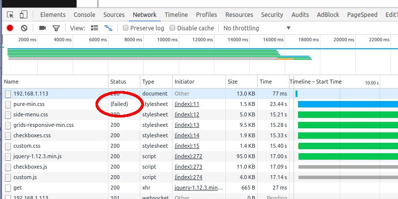

Hey,
I developed a huge Webpage project for a ESP32 with Bootstrap 4 and ESPAsyncWebServer which supports serving .gz files. As I write the page I have to manually GZIP the Javascript, CSS and HTML files before I upload them to the ESP32 SPIFFS Datasystem.
So my question is: Is there a way to implement a script which starts the 7ZIP Program and uploads the files after 7ZIP is ready?
Thanks :slight_smile:
Environment: Win10, VS Code (V1.30.2) with PlattformIO (V3.6.3), ESP32_DevKit_V4
