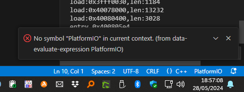

The error message has returned!
data-evaluate-expression message
In my experience, when running the debugger, it tries to evaluate every possible text that’s underneath the mouse cursor as an expression or variable name to show you its value. Often times that fails and thus you get an annoying popup; otherwise it’s harmless.
Thanks but I wouldn’t call it harmless - my OCD is maxing out :grinning:
