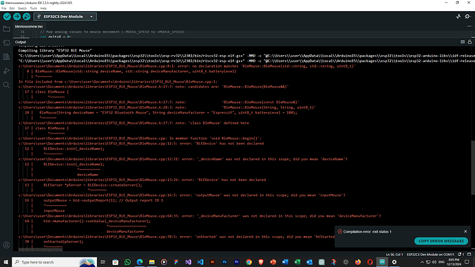

But my program can’t finish the processed and fails, so what should i do to fix it?
Here, the full error message
Please show the full platformio.ini and src/ files.
Can you please try this and try building again.
Ok, now i included, saved and then it worked. The first time i included it didn’t work, but i guess i forgot to save it. Thanks a lot and sorry to bother
Don’t use a 2 year old library with the latest Arduino-ESP32 3.x core. Or use a fixed version of the library.
