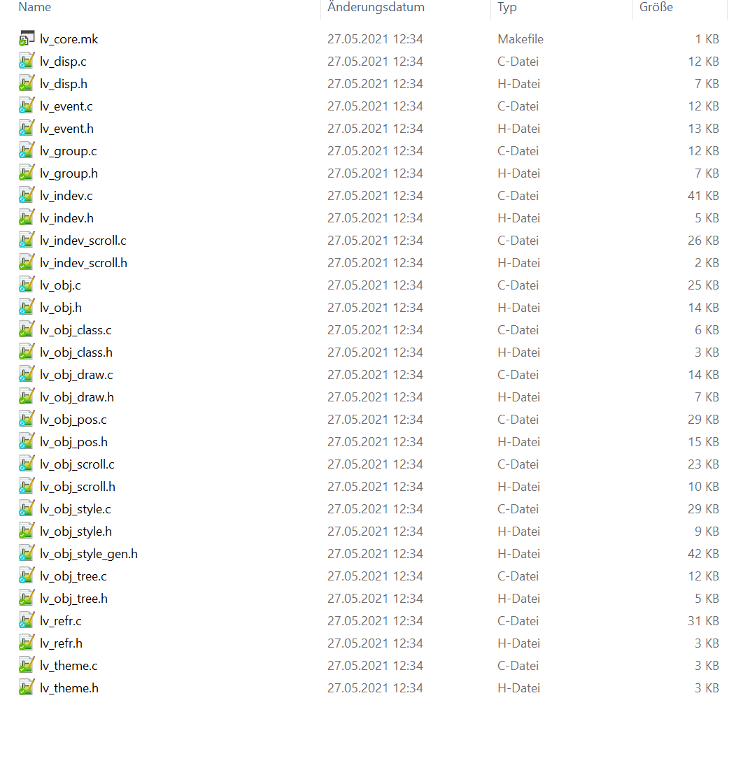

says it installed v8.0.0. (Which isn’t even listed here but okay.). Per https://platformio.org/lib/show/6598/lvgl/installation version 8.0.0 was published March 16th 2021. So it can’t have possibly included lv_event.h that file was created after relase.
