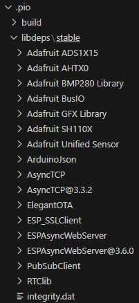

As far I can pin it down, problem is combination of ayushsharma82/ElegantOTA which includes as dependency some specific versions of ESP32Async/ESPAsyncWebServer and ESP32Async/AsyncTCP and at the same time I’m referencing same libraries but latest versions (for my web part of the code).
When I compile the code, it ends with lot of warnings (for AsyncTCP.c) and at the end it fails, here is just a sample:
C:\Users\Ivan\OneDrive\Projects\PIO\ESP32\eGrunt\v1.0.1/.pio/libdeps/stable/AsyncTCP/src/AsyncTCP.cpp:813: multiple definition of `AsyncClient::onPacket(std::function<void (void*, AsyncClient*, pbuf*)>, void*)'; .pio/build/stable/lib7fd/libAsyncTCP@3.3.2.a(AsyncTCP.cpp.o):C:\Users\Ivan\OneDrive\Projects\PIO\ESP32\eGrunt\v1.0.1/.pio/libdeps/stable/AsyncTCP@3.3.2/src/AsyncTCP.cpp:776: first defined here

Here is how libdeps folder looks like:
