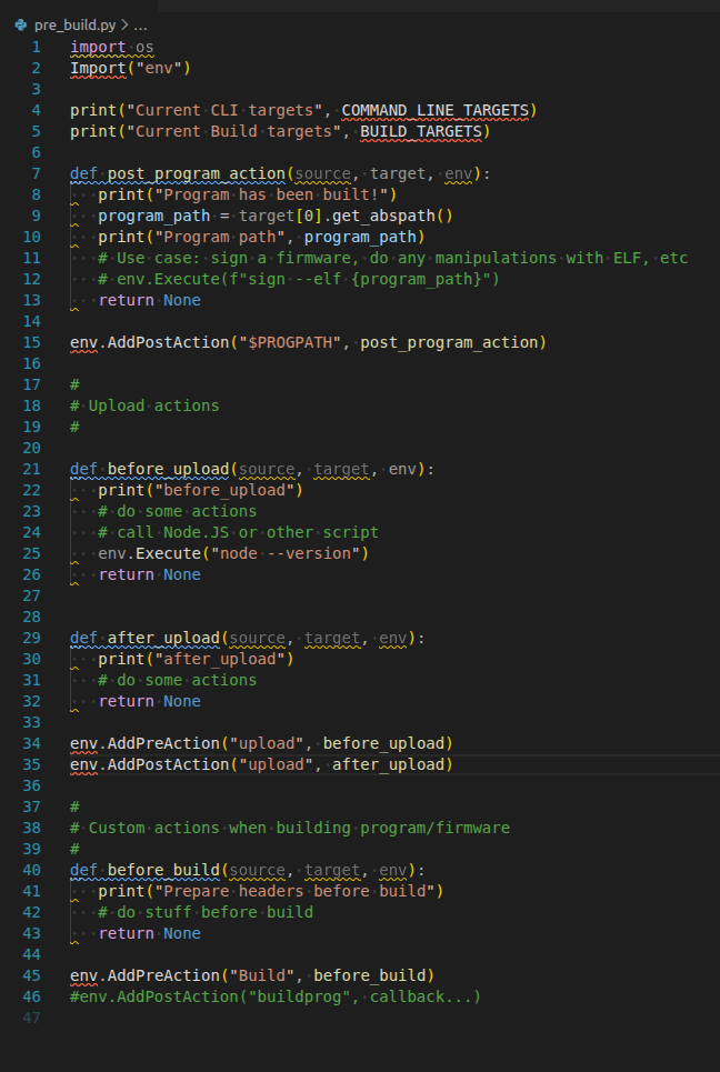

Dear PIO Team,I wanted to trigger some pre action for an ESP32 build to prepare some Web files.I did the following:
1.) create a pre_build.py file like:
# Custom actions when building program/firmware
def before_build(source, target, env):
  print("Prepare headers before build")
  # do stuff before build
env.AddPreAction("build", before_build)
2.) add pre:prebuild_sript.py to my env
[env]
extra_scripts = pre:pre_build.py
But “print Prepare headers before build does not apear when I build.
What doe I make wrong?
The complete File looks like:
Same with buildprog instead of build?
Might also be related to

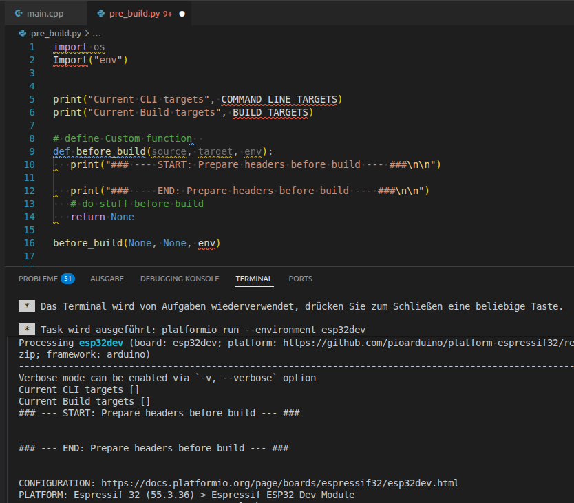

Hi MaxGerhardt,
yes same with “buildprog” or “build”.
The strange thing is the post programm action works but the pre actions does not occur.
I think it would be vaoid to immediately execute the “pre build” function directly in the script, without it being attached to a pre action. Like, a direct function call to whetever you want to do.
You mean directly after line 3 ?

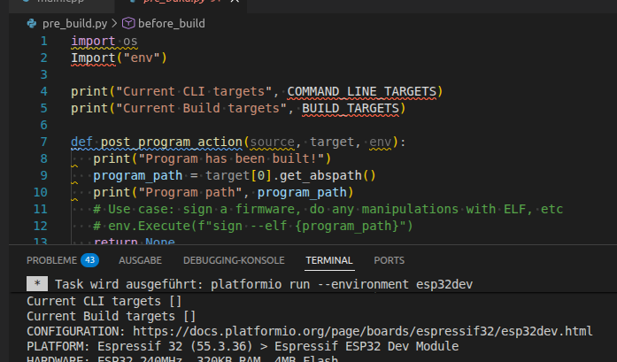

The print of the
“Current CLI…” and “Current Build targets” occur as empty array.
Can i call a bash script here in this file?
Do i need some subprocess stuff then?
No, instead of
do
before_build(None, None, env)
Wait a minute….

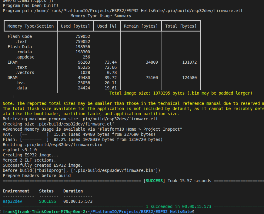

I saw actually the first time the output of the preaction but it is not repoducable
Clean and build?
pio run -t clean
pio run
on CLI.

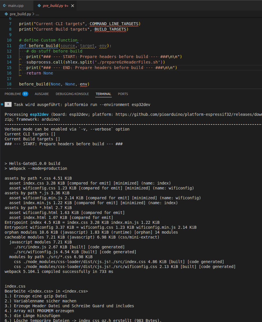

Here see my image it appears at last after build…
see last line in pic.
This works like:

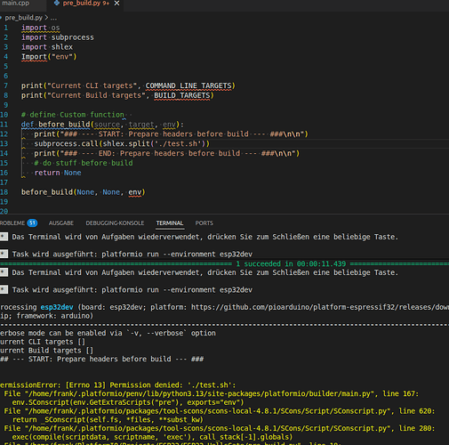

Any Idea to run a shell script in the pre_build.py script?
import subprocess
import shlex
subprocess.call(shlex.split('./test.sh param1 param2'))
Tried already but get permission denied.
  1. Script path may need to be absolute
  2. May need chmod +x test.sh
  3. test.sh must exist
  4. maybe try it with shell=True as additional parameter in subprocess.call()
  5. otherwise explicitly /bin/sh /test.sh instead of ./test.sh.
Great Stuff!
can now build webpack header files before build.
Thank you so much !
