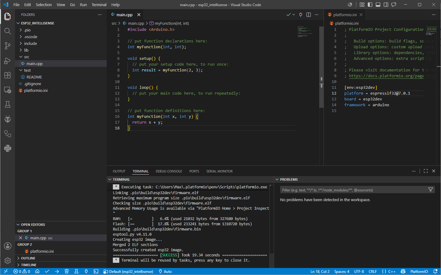

You’re not supposed to get Intellisense errors in a new project that builds cleanly in the first place. Are you using Microsoft VSCode + PlatformIO? Or VSCodium / OSS VSCode + Clangd? The PlatformIO extension is designed to work with Microsoft’s C/C++ extension, not clangd.
Originally it was VSCode and the PlatformIO extension without clangd enabled and I was still getting intellisense warnings despite the project building fine and working on the microcontroller. I think after I closed and reopened VSCode it suggested to download clangd instead which I did, but I was still getting errors, so I just asked AI to see if it could get rid of the intellisense warnings. Which it did do that and from there I just put it into that wrapper above.
I can’t reproduce that at all.
What Intellisense errors were you getting?

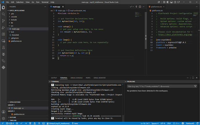

I honestly have no idea then. When you created the project do you just run “rio init –board ESP32dev“.
Correct. pio init -b esp32dev. VSCode will autogenerate the .vscode intellisense configuration automatically then, triggered by the PlatformIO VSCode extension. I only added @7.0.1 to force the usage of the latest official Espressif32 platform version instead of PIOArduino.
Guess I’ll experiment with it then, there is a chance that I did something wrong. Thanks for your input.
