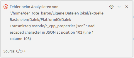

It adds two backslashes to the directory, which in turn leads to this error message (sorry for the partly german text; the whole IDE is set to english, I don’t know why these messages keep popping up in german…)
grafik
As you can see, this happens in both of the “blocks”. I understand the reason for the error message, PIO tries looking for the data in a directory which doesn’t exist. When I delete the two backslashes, everything ist fine, but they return as soon as I change something in the platformio.ini or reopen the project. Not the end of the world, but I find it pretty annoying.
Has anyone an idea, why PIO/VSCode feels the need to mess up the path and how I can stop this?

This is issue is ancient and supposed to be solved already.
https://github.com/platformio/platform-ststm32/issues/655
Are you sure you’re on the latest ststm32 platform?
Open a CLI and do
pio pkg update -g -p ststm32
followed by Ctrl+Shift+P → Rebuild Intellisense.
Thank you for the fast reply.
No, not at all. It’s more likely that I installed the platform once, some four years ago, when I started to work with the STM32 and then never touched it again.
I will try your suggestion later this evening or tomorrow at the latest and share the result
Okay, I just tried it out.
One change of platformio.ini and one complete restart of VSCode without messed up c_cpp_properties.json. It seems that the update did the trick (I was still running Ver. 15 of STM32, the update made it Ver. 18).
Thank you very much, that will save me a lot of grunts and eyerolls
